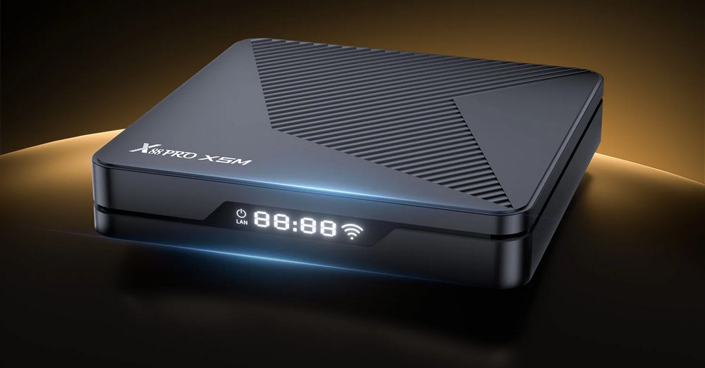

Followed Troys tutorial on how to flash Slimbox Firmware to a x88 pro android box and it worked a treat, took about 6 attempts to flash it across from PC to Box but it worked and the box is now lightning fast. Quite pleased with myself being a noob.Thanks Troy
@TROYPOINT So if I wish to run this X88 Pro X5M just AOSP as it comes out of the box, installing Projectivy on it, then would Slimbox be of any benefit? I see you can install AOSP version, but If using that & rooting it will enable me to use accessibility options &/or enable the microphone to work that google blocks wrongfully in my opinion, then it is of no use to me. I just ordered one of these to build up for my daughter so I do want to figure out if doing the Slimbox gig would be of benefit.

If you’re going to keep using AOSP I don’t think I would bother installing SlimBoxtv. The only reason you might want to do that is 1. If you are in fear that the original firmware has malware…I don’t think it does. 2. You want the added SlimBoxtv features that I show in the video.
@TROYPOINT Thanks a bunch Troy for confirming this. I watched the video & the extras aren’t anything I would care about really, & I agree you on the malware issues of possible malware in firmware not being a problem. This is certainly a great way to get Android TV in to the device for sure & is a great option for those who desire it. Thanks loads for bringing this to all of our attention also as I didn’t know about SlimBOXtv at all.
