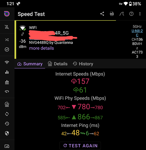

I’ve been having issues with horrible recording quality using TiviMate and various FireTV devices. I purchased a 4K Max (with 16GB memory) and it arrived yesterday. The wireless performance is great on this device.
Anyway, I still had recording quality issues. I checked the thruput using Analiti while Surfshark VPN was active and I only had 14Mbps download thruput. I went into the Firestick’s network section and turned the wireless network off and then back on. Then I enabled Surfshark VPN and redid the Analiti thruput test which yielded 97Mbs download thruput.

Surfshark vs Proton VPN performance (for me - VPN POP location: Miami, FL). I did each test twice so that is why there are two numbers per entry.
Performance Test No VPN SurfShark
VPN
Proton
VPN
Cable modem to Mesh wifi to FireStick 4K Max (using Analiti) 153 Mbps
127 Mbps
95 Mbps
100 Mbps
62 Mbps
75 Mbps
Cable modem to Mesh wifi to FireStick 4K Max (using the FireStick Network speed test) 85 Mbps
72 Mbps
69 Mbps
82 Mbps
66 Mbps
77 Mbps
What’s really missing here is a test thru RealDebrid. But, I’m not sure how to measure that performance. Anyway, SurfShark is about the same or a little faster than Proton. Plus SS costs less so I will continue using that vs Proton. Every user’s thruput performance experience will be different. By the way, I purchased both products and did not use their free service which I believe has less thruput performance.

Hi Tim. Thanks for the tip. I downloaded it and ran it. The funny thing is it doesn’t give any information on what it did. It sure does sound like a scam. but, i will find out tomorrow when my scheduled records take place.
Tim, this tool really rocks! Thanks again for the recommendation.
It dramatically increased the bandwidth performance big time! Even with VPN (SurfShark). Hopefully it is not an anomaly, but I ran analiti before and after and it works! I’ll keep doing that over the new few days to see if it is consistent.
