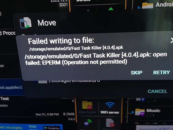

I also tried the X-plore app and when I tried to move any of those apps instead of an apk file it pulls up a zip file and I get a message that it can’t transfer all files. (See attached, Fast Track Killer is the only app that showed an APK file but still would not move.)

My problem is under both situations, using the ONN device to move the app or using X-plore to move the app, the app will not move and the only difference I can discern is that on the first device I installed all the apps (with external drive already installed) from Troy’s video while I was using google as a homepage and then went to Wolf Launcher.
While on the second device I had Wolf Launcher running as my home page and then installed external drive. At that point all the apps associated with the Wolf launcher installation will not move to external: (Launcher Manager, Sideload Launcher, Wolf Launcher, Jio Sphere and Fast Track Killer).

In E-plore when I try to move an app from internal to external, I hit move, it asks me if I want to delete the app from internal and I choose yes, then it creates an apk file in Downloader on the right side column and asks me if I want to install. When I install the app goes to the external and then it gives me the choice to delete the apk file and I am done.
This process does not seem to work now that I had Wolf Launcher etc. installed, before the installation of the external drive.
