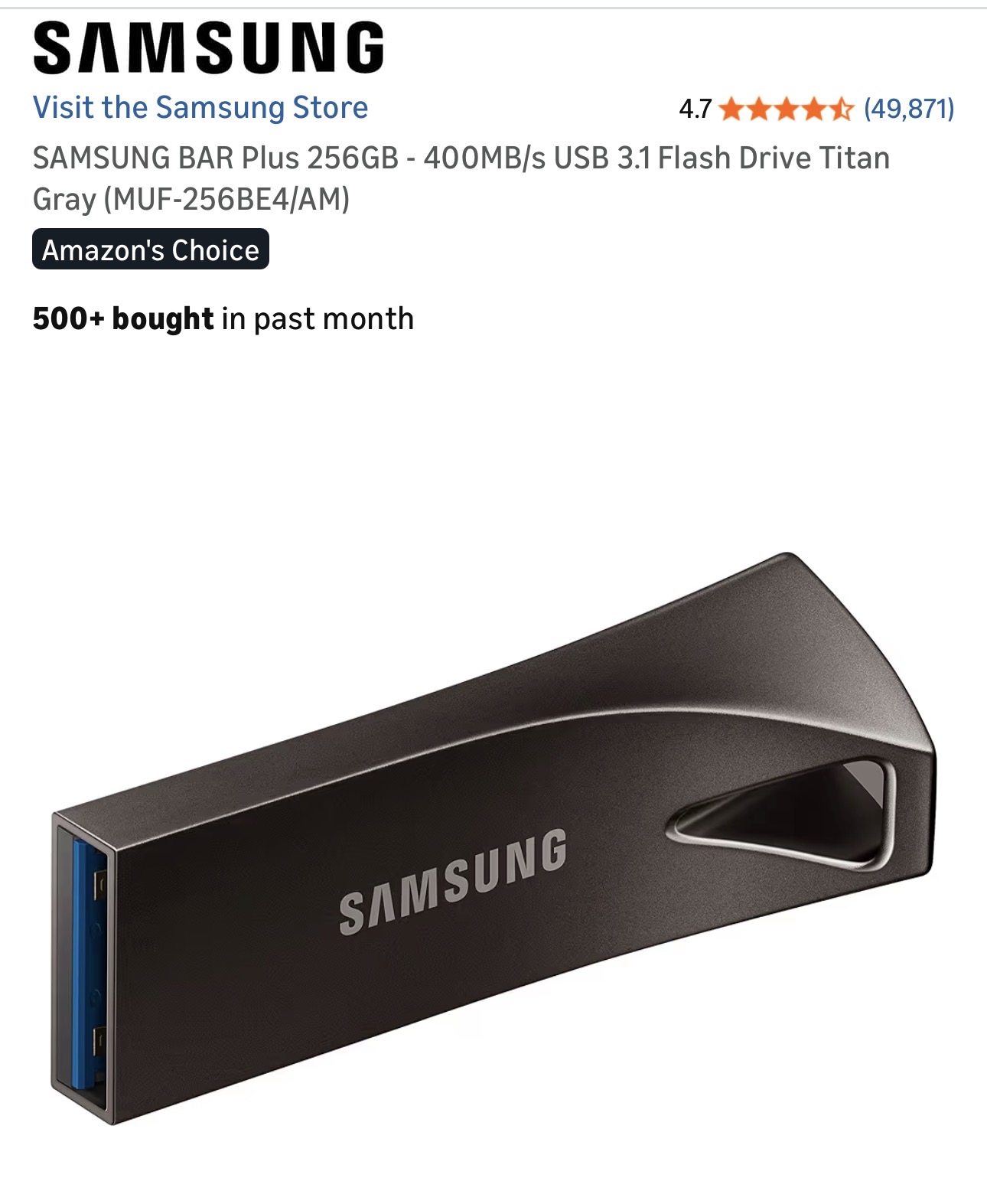

Sometimes on reboot the usb won’t stay connected. Do you think I need a stronger power brick or maybe a powered usb hub? Overnight the usb did stayed connected though. Anyone have a usb issue staying connected? I’m using this one. Thanks
