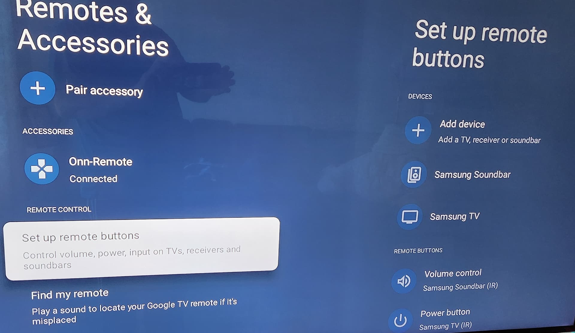

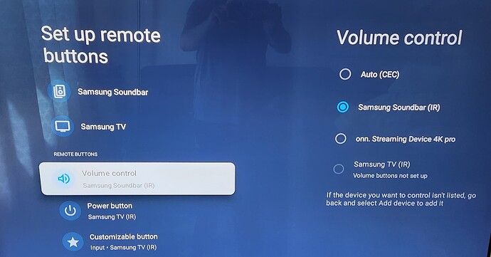

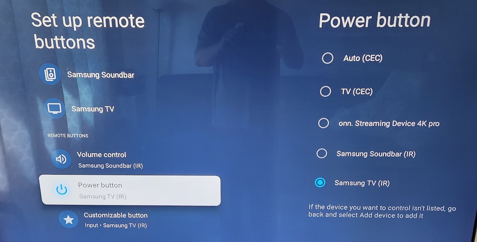

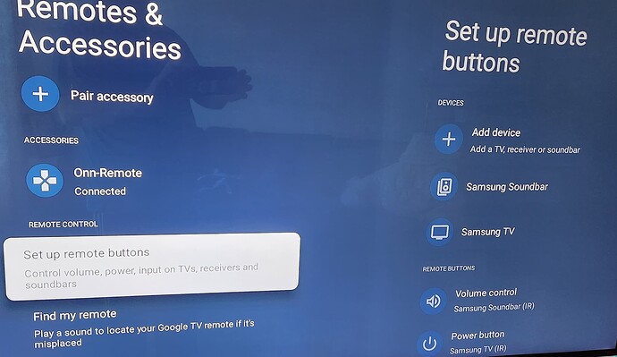

I’ve thought about this and i may have both power on together because my tv is set up with Anynet+ (hdmi cec).
So when my tv turns on the sound bar does as well.
I have the onn remote set up as IR so the SB volume works on the onn remote.
I would check to see if you can set it up this way too.

Im not at home right now but if I remember correctly, when you go to settings and remote setup the onn pro gives you a few opinions. There is CEC, IR and one or two others.
It tells you what you set up each remote as. I’ll try to take a pic later of my set up.
But my Samsung tv is set up as Anynet+ (hdmi cec). That’s where i believe the sound bar is getting the signal to power up the soundbar. Not sure if the option in the onn pro will work the same.
Yes my Samsung TV Anynet is enabled and soundbar is connected via optical to TV. I’ll play with it some more but if you could send Pic later I’d appreciate it…

Here are the pics of the way i set it up and works for me.
Let me know if you have any questions. Good luck! :crossed_fingers:
