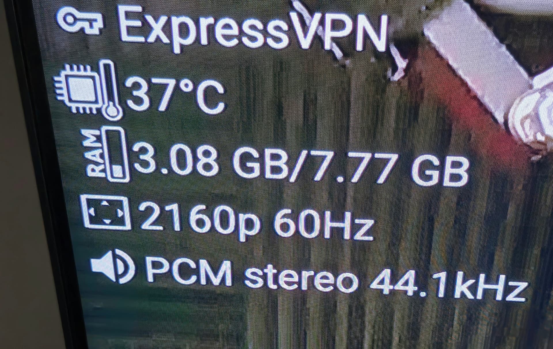

Wow, that is kinda high. I’m usually around 37. :grimacing:

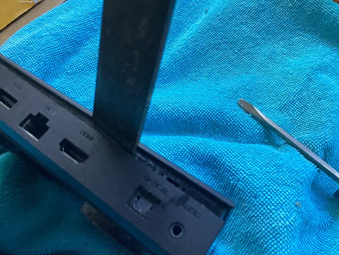

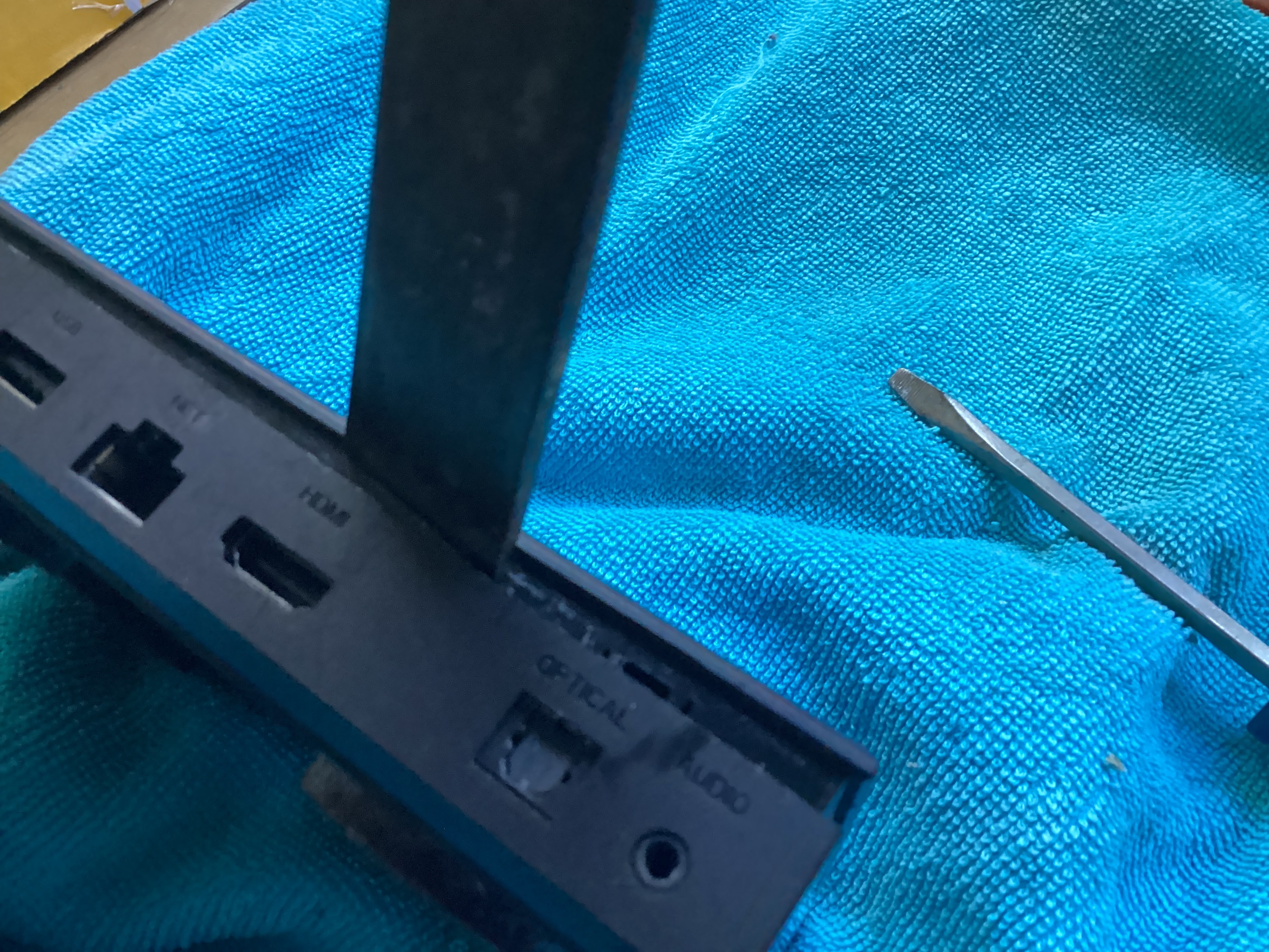

10-4 good buddy. The key is to carefully use a metal wedge to gently get the rear of the box separated from the top then gently pull the top up and off before disconnecting the power light cord. Then simply unscrew and take out the mother board, then drill your holes, doing small pilot holes before using a bigger bit.

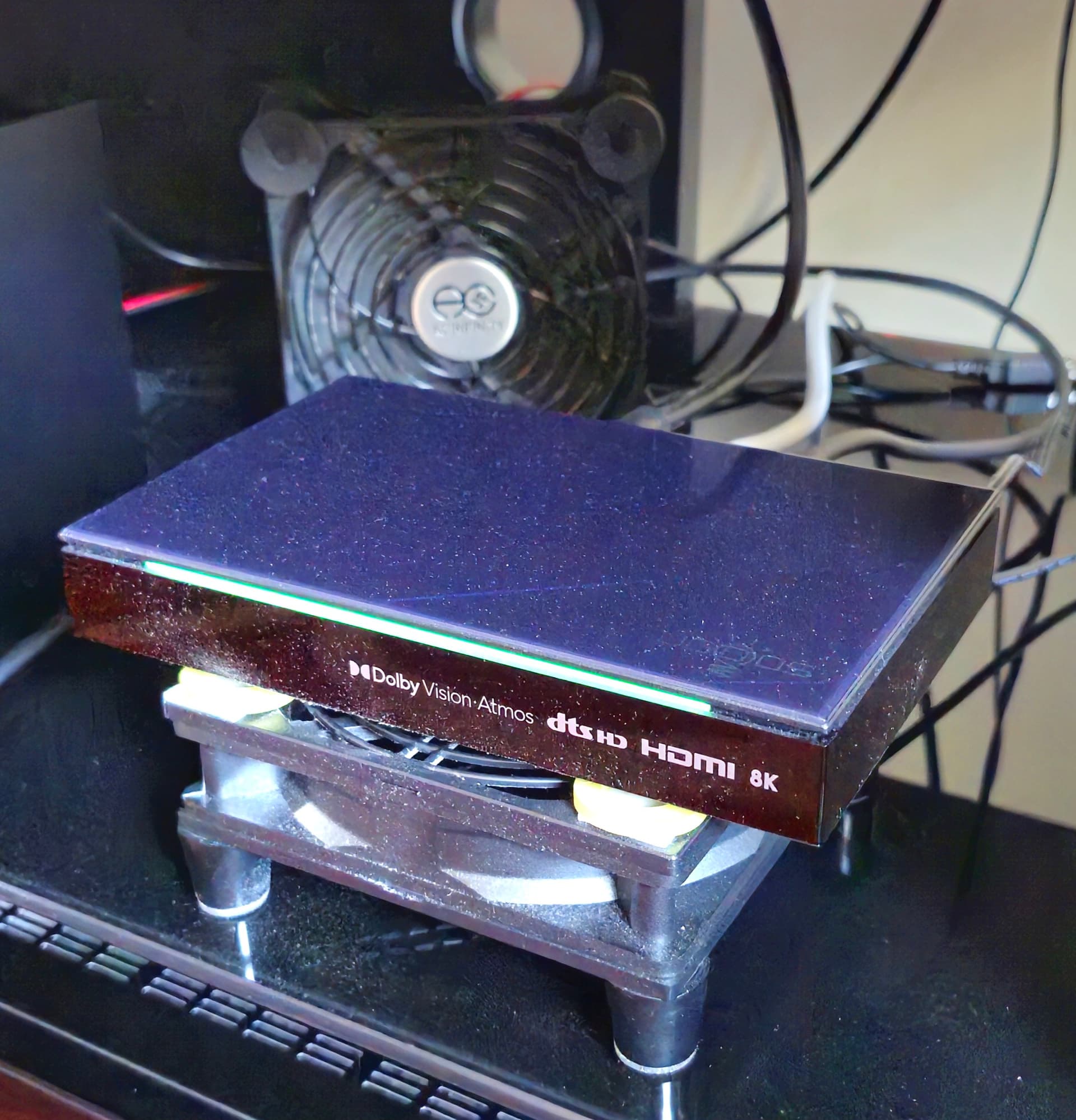

Still sounds warmer than it should be. I haven’t made any holes but I do have 2 fans on it. The fan it’s sitting on is blowing upward and I remain pretty steady between 37-39. I do keep the room temperature around 19°C. By any chance @Miki are you still trying to get those Mexican temperatures up here in Canada. :sweat_smile:
