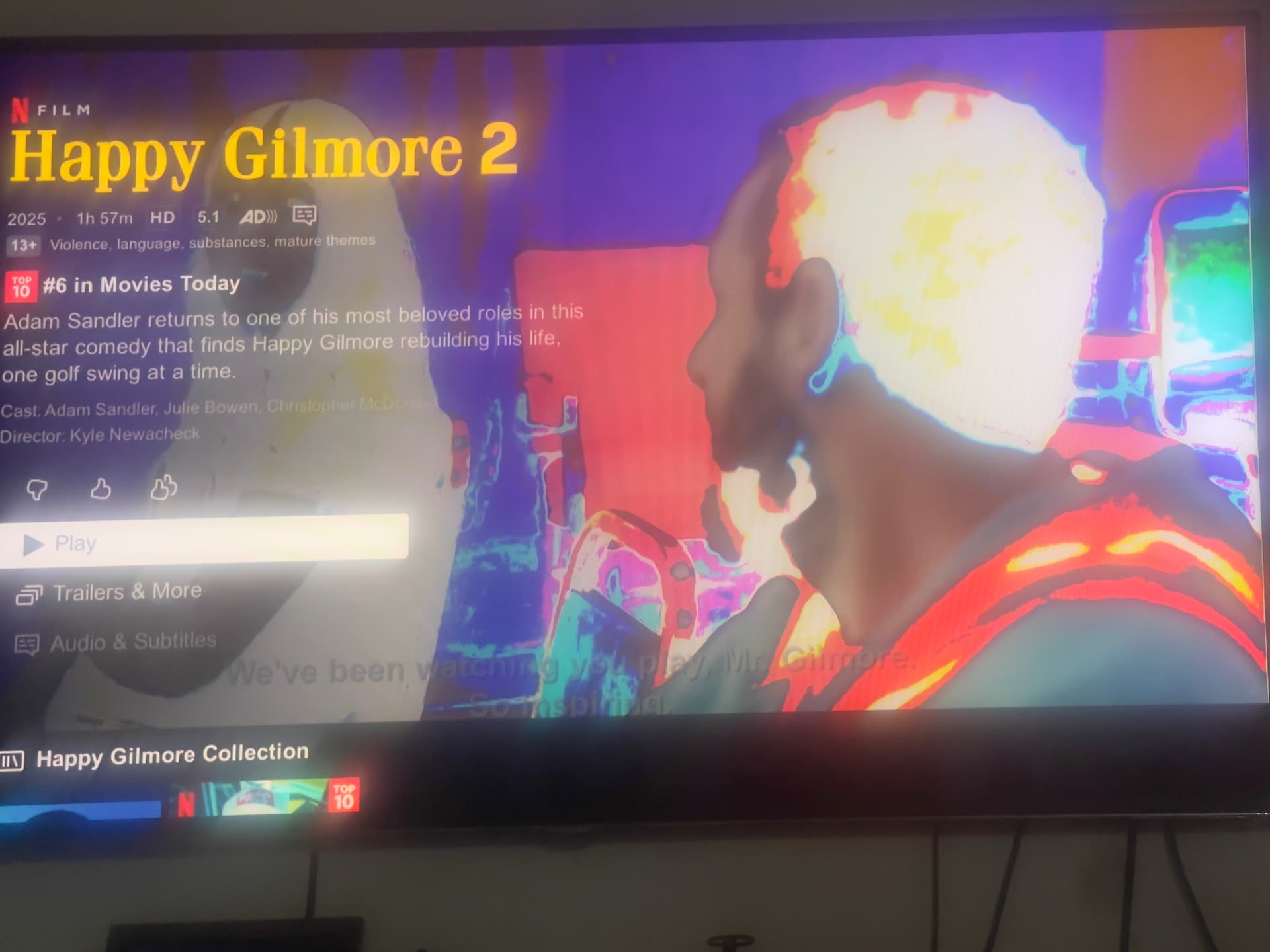

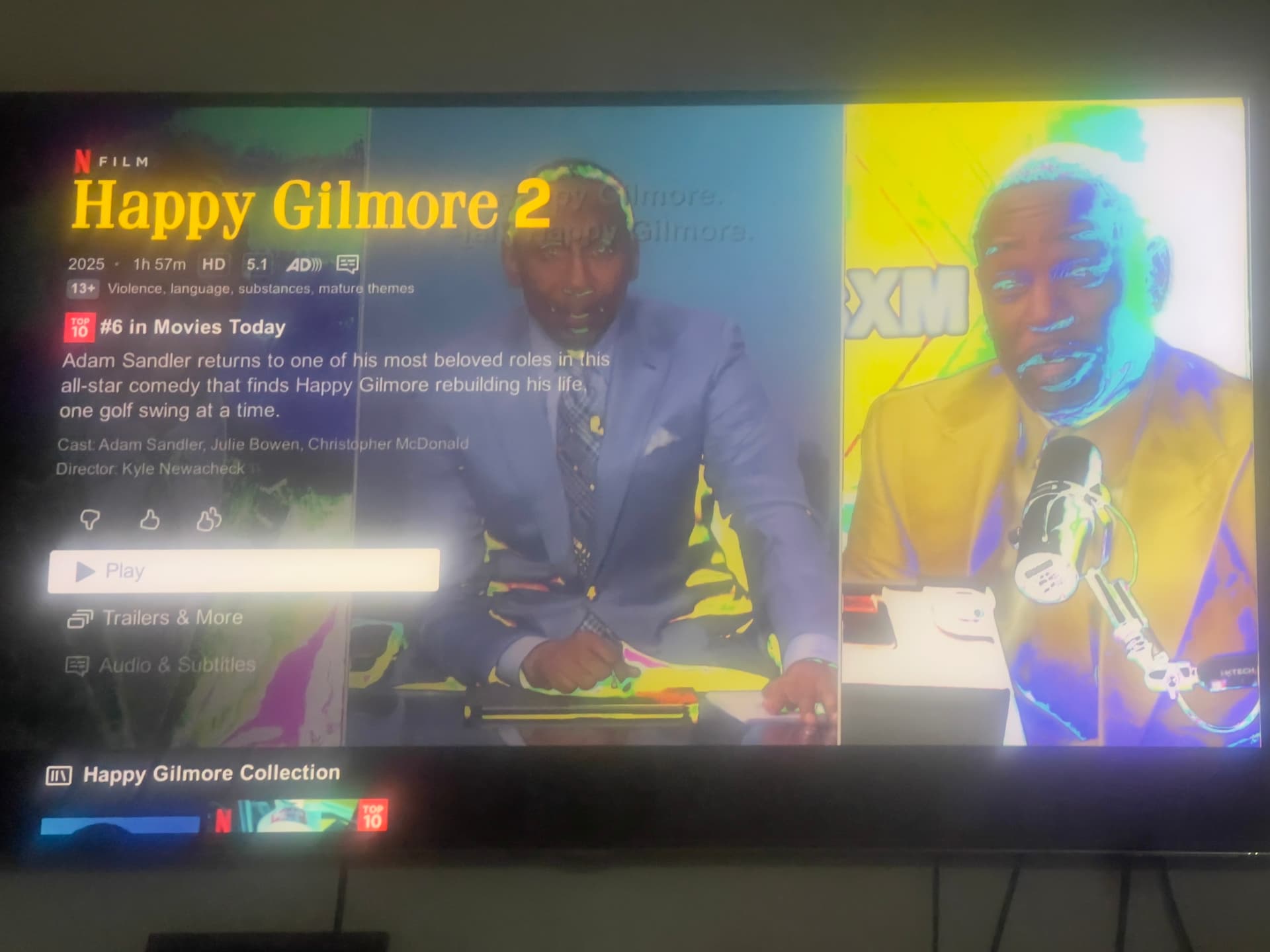

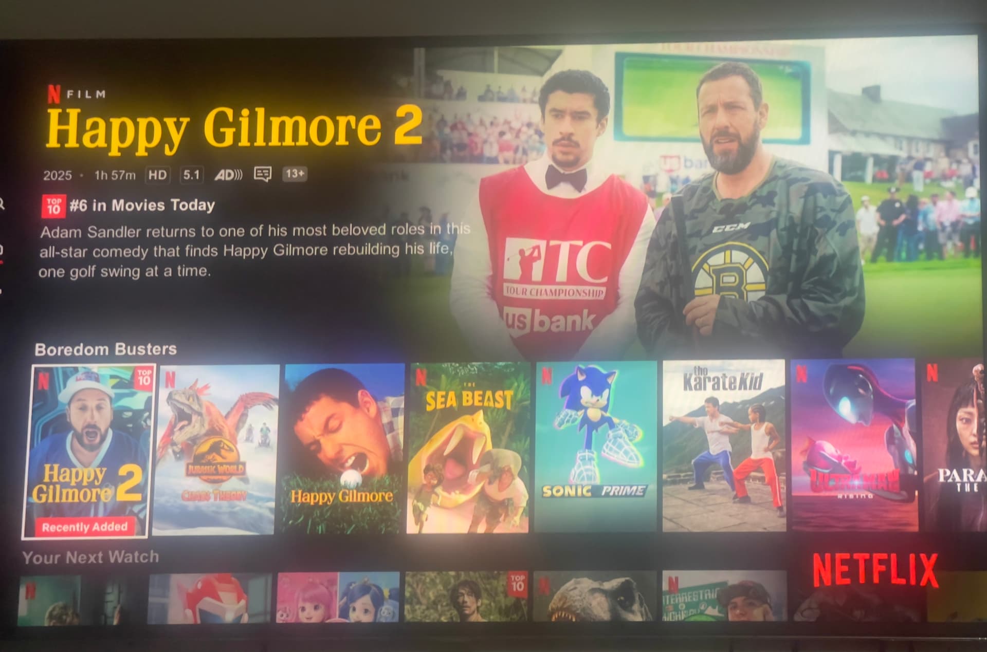

So my family were watching Netflix and all of a sudden the colours went wild. (See provided pictures) Strange thing is it’s only in the video, still images are text are okay. I tried restarting the TV and resetting the picture. Also tried my Android box and it’s the same. Do I need a new TV?
Time for a new TV?
I was afraid of that
Hey wallyworld has great deals on new tv’s..65-75 inch for 3-400US…i spend that on beer…lol
Looks like you’re trying to watch Dolby Vision content on a non-compatible TV. Usually Netflix would choose the right steam. You did turn off the TV and anything connected to it and unplug from the outlet for 5 minutes or so and try turning it back on, right? If that doesn’t fix it then yes, you need a new TV.
I did turn it off and back on. I’ll try your suggestion next. Thanks!
Turning it off and unplugging it did the trick. Thanks much!
