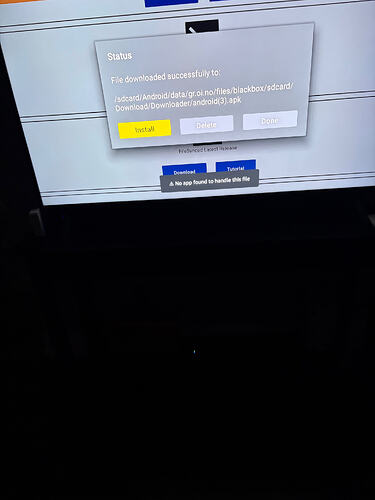

Having trouble downloading apps from Troypoint Toolbox. Tried downloading XCIPTV & Sparkle TV.
I get a window that says Status. connecting…and it never connects.
Also, IPTV SMARTERS PRO stopped working on my ONN box. It is not the ONN PRO 4K. Never had an issue before now.
One issue I have heard about that may cause this behaviour is using an ad blocker. If you have one turn it off, also if using a VPN try turning it off and then connecting and if that works thena once done be sure to turn your VPN back on.
If using a VPN try disabling that temporarily and see if that fixes the problem.
