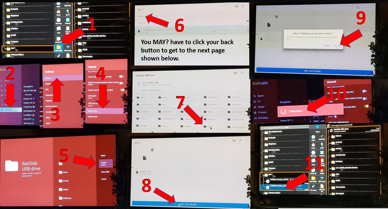

Using X-Plore for this demonstration.
First go into your File Explorer and create a New Folder, (Ex: Test 1)
Then follow the steps listed below.
Go to Settings>>General>>Backup Data>>System Picker (far right column)
Scroll to where you created your folder and click it (Pro Tip: Files are in alphabetical order so name your fold accordingly. A’s are up front and the T’s (TEST) are way down there! lol
I made a Tivimate folder and then made a Backup file and a then made a recording folder. So, when you record or do a backup select the appropriate folder to do so.
