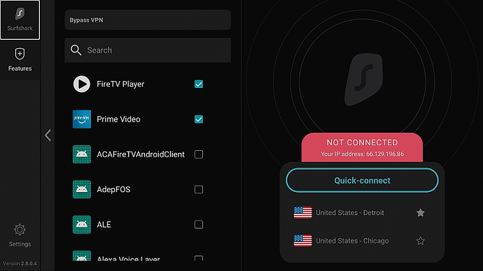

I’ve been using IP Vanish now for several years. I have Amazon Prime split tunneled so I can access it when IP Vanish is connected. I have Prime Video (com.amazon.avod) and Fire TV Player (com.amazon.firebat) selected for split tunneling and it works just fine.
With Surfshark I set the Bypasser with the same two apps selected (Prime Video/Fire TV Player) and Amazon is blocking access. Is there something else I need to do so I can use Amazon Prime while Surfshark is connected to a VPN server?

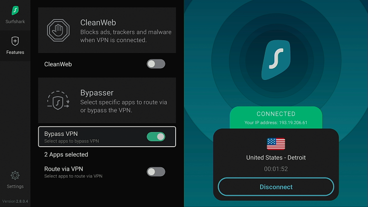

Hello @jmanguray I just tested this myself. Split tunneling is working properly for me by checking the same apps that you are checking. Here are my settings. Make sure you are using the Bypass VPN setting and not Route via VPN. If your settings are the same as mine, try rebooting your device and try again. Working fine on my Fire TV Stick 4K Max.
