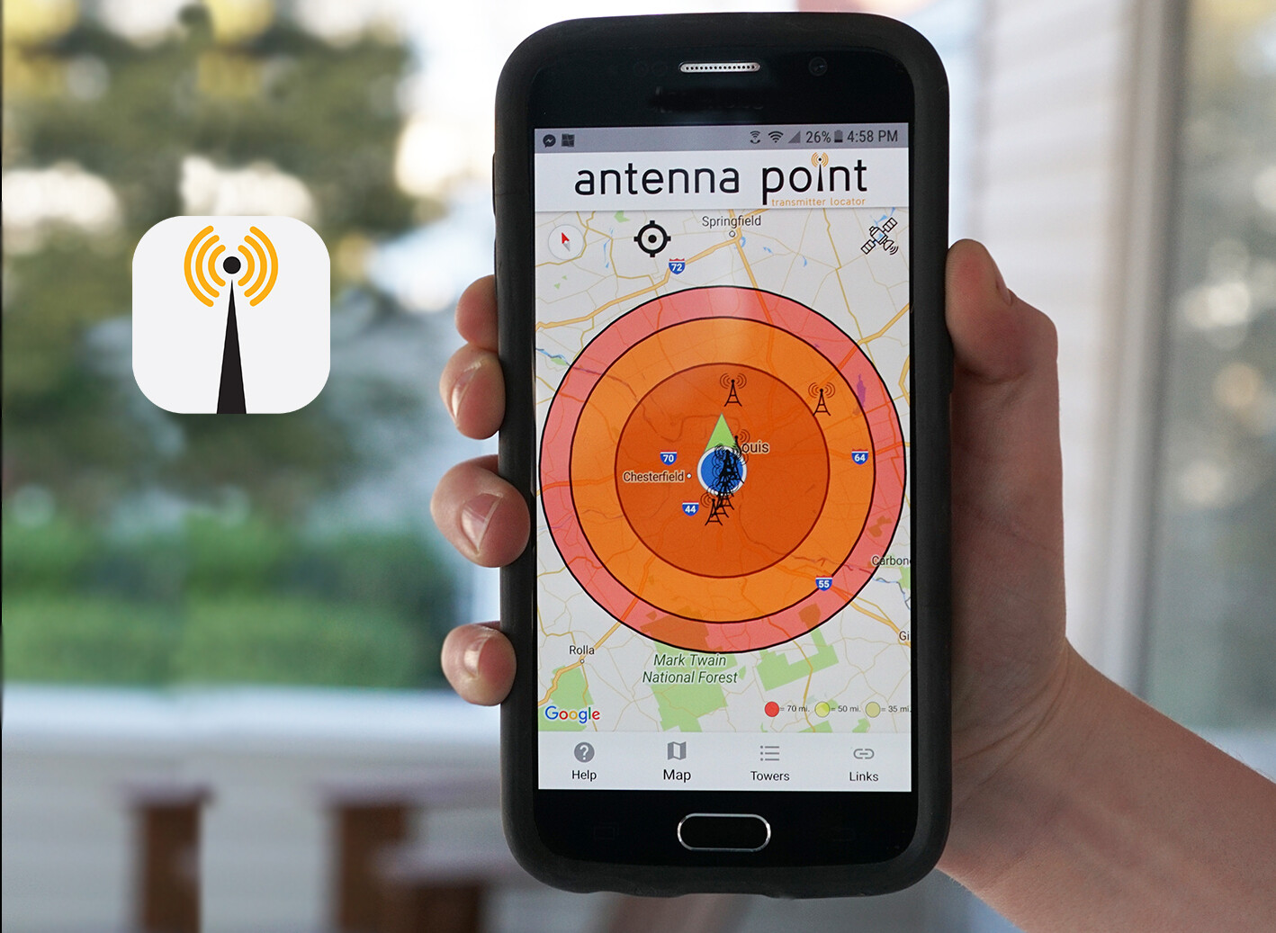

I was browsing through these and I saw this.
So I just went last weekend and visited my old school friend and his wife, they live on Saginaw Bay in Michigan, Pinconning to be exact. (Pinconning says it’s the pot and cheese capitol of Michigan :slightly_smiling_face:)
He has satellite Internet which kind of sucks but had a giant antenna on the house, moter that didn’t work and pointed away from the closest towers.
We decided to see if we could set it up, so we talked about what was needed and I was pretty sure the antenna was good enough as we talked his neighbor came over and said it’s not a digital antenna. So I explained to him there is no such thing. So yes the idea you need a special antenna is too common!
BTW we got it all squared away, we cut out extra coaxial and spliced it (it was cut off and just had a big bunched tied on the side of the house), repointed the antenna by loosening it and using a pipe wrench for leverage to turn the pole, downloaded a compass to my phone and went to antenna org, got the directions to station, worked great, he gets not a lot of channels, 20 or so but he was really happy with that.
He was talking about dropping DirecTV when I left. I also connected a old Firestick 4k he had but never installed, good friend and I think smarter than I am but a luddite. The 4k worked well, Hughes showed 11 Mbs so, hope it holds, satellite does suck. IMHO

One of the biggest issues for ota peeps is pointing the antenna in the right direction. My antenna is in my attic and I get over 100 channels from about 45 miles away.
