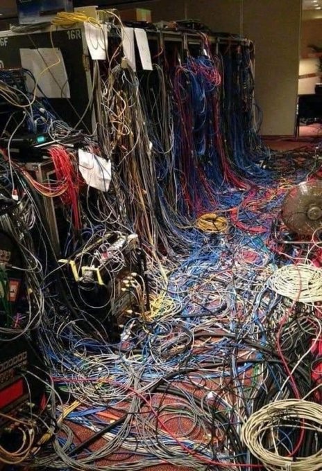

Yes, get a new bedroom.
Helpful as always ty@Miki
Yeah just leave it on the west side of my town it’ll be gone in 10 minutes. Copper is a lot of money! LOL
not sure should i cut the red or the blue wire
Get a bigger bedroom.
