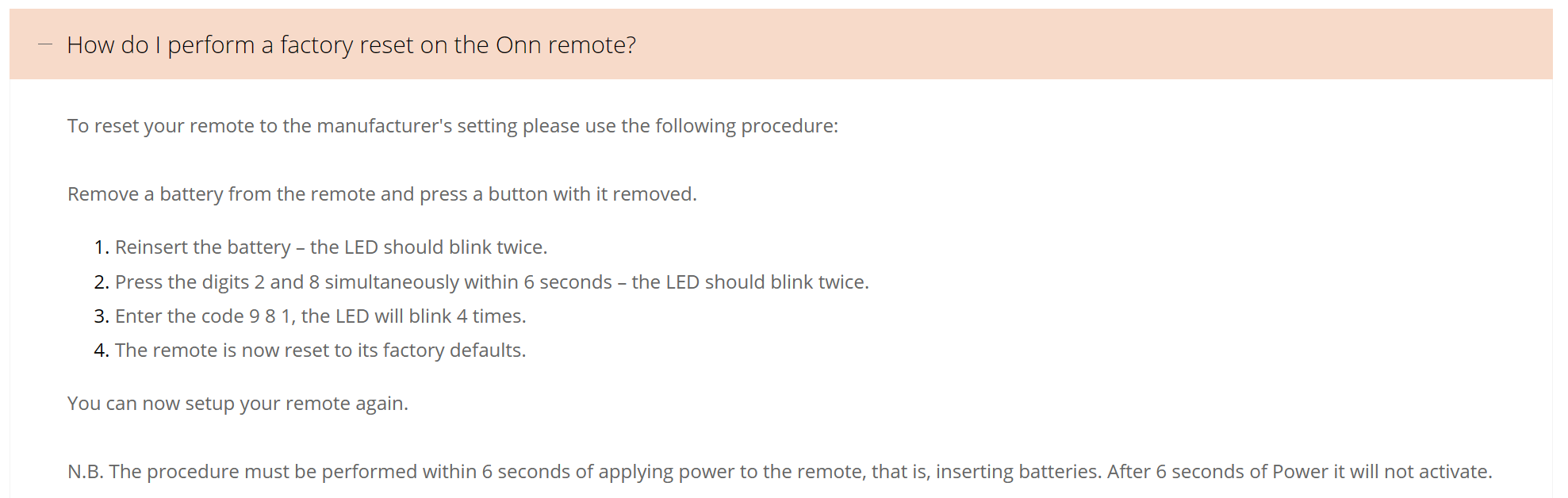

Here’s a guide and a link for ONN Support:
ONN Support (onn-support.com)
