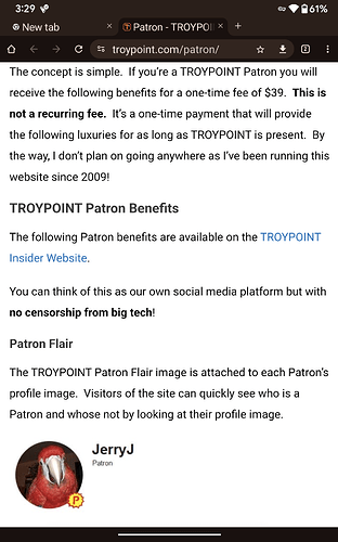

Oh hey @JerryJ I forgot to congratulate you on your celebrity status. You made it onto the front page of a TP Tut. Now as your agent my recommendation is never to give free autographs. $5 ea.

HUH? what’s that? What did I win :blush:?
:joy:. I’ll see if I can find it again. It was in Troy’s latest E:mail.
:clap: :clap: :clap:
Gosh, I’ve been a Patron for several months now.
