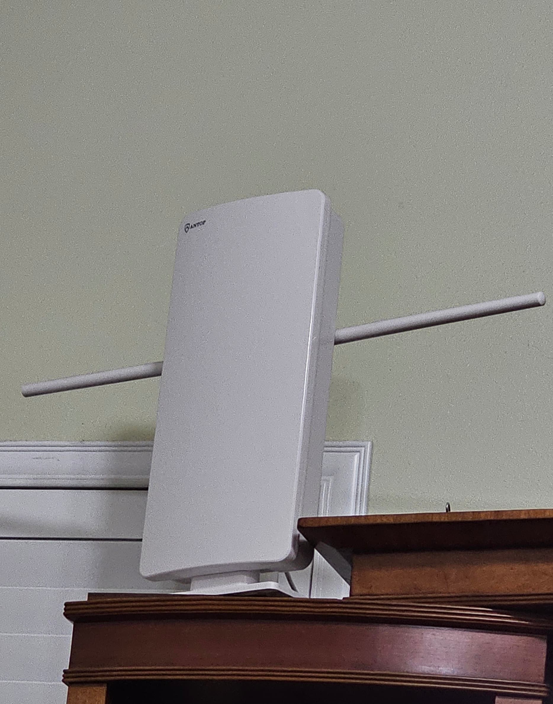

This antenna works great for my local channels.
