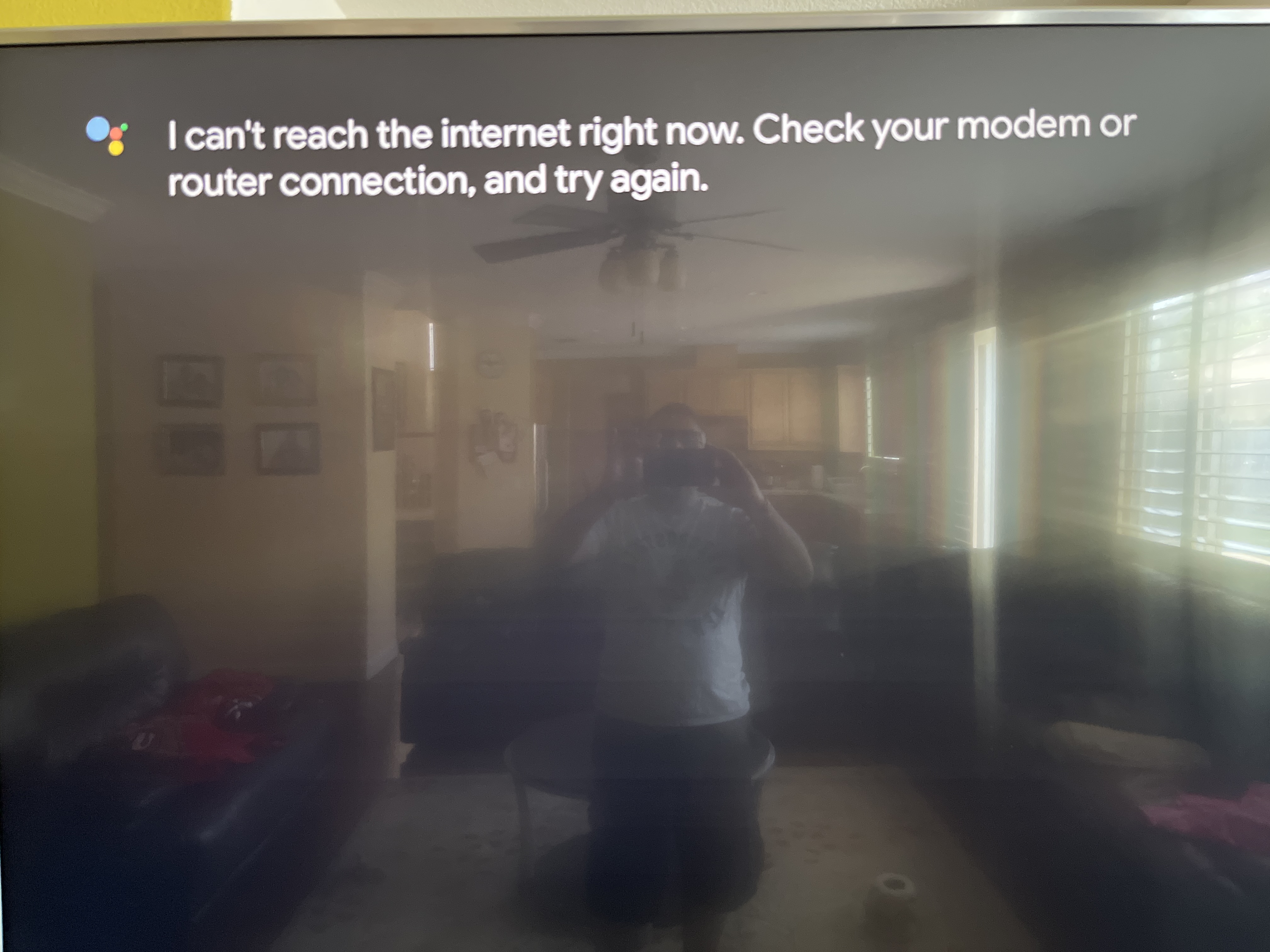

When I try that I get a message saying no WiFi connection
Hello @akapoor16 this is usually due to installing the wrong launcher (Fire TV).
Try this. On your remote hold down on Google Assistant Button and say open settings.
Go into Apps/See All Apps and open Launcher Manager from that location. Then try clicking Disable Custom Launcher.
If that doesn’t work, try uninstalling Wolf Launcher and see if that opens default launcher again.
If that doesn’t work, try uninstalling Launcher Manager from same location.
Finally, you can get to Factory Reset in those settings as well if you can’t get any of the above to work.
