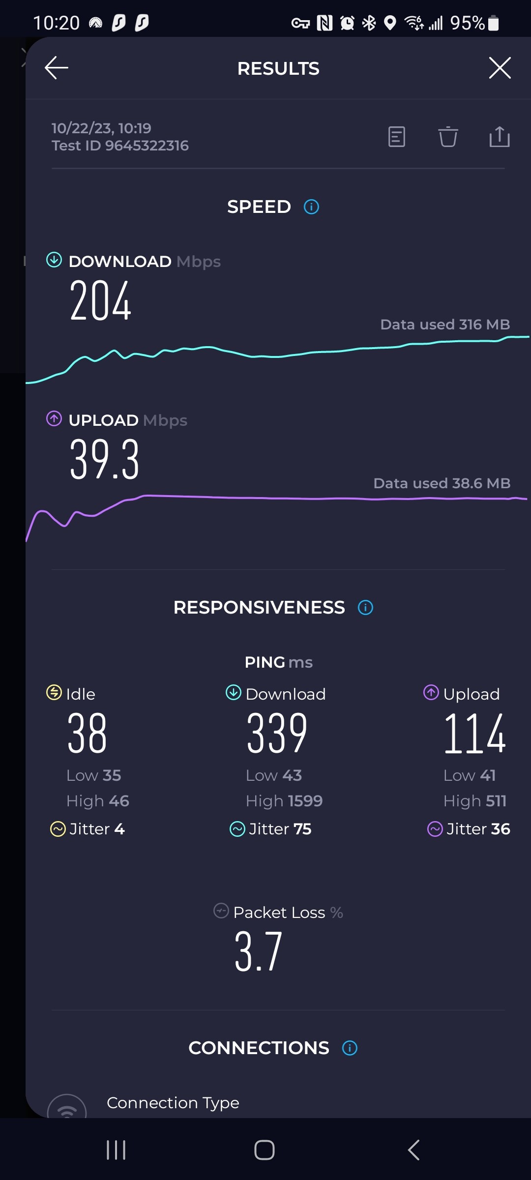

The company is called “Ookla” and I’ve used them for years. Yes, they have both an app and a website.
App is called “Speedtest by Ookla” and it can be dl’d from the Google Play Store for Android.
Their website is https://www.speedtest.net/ and it works very well also.

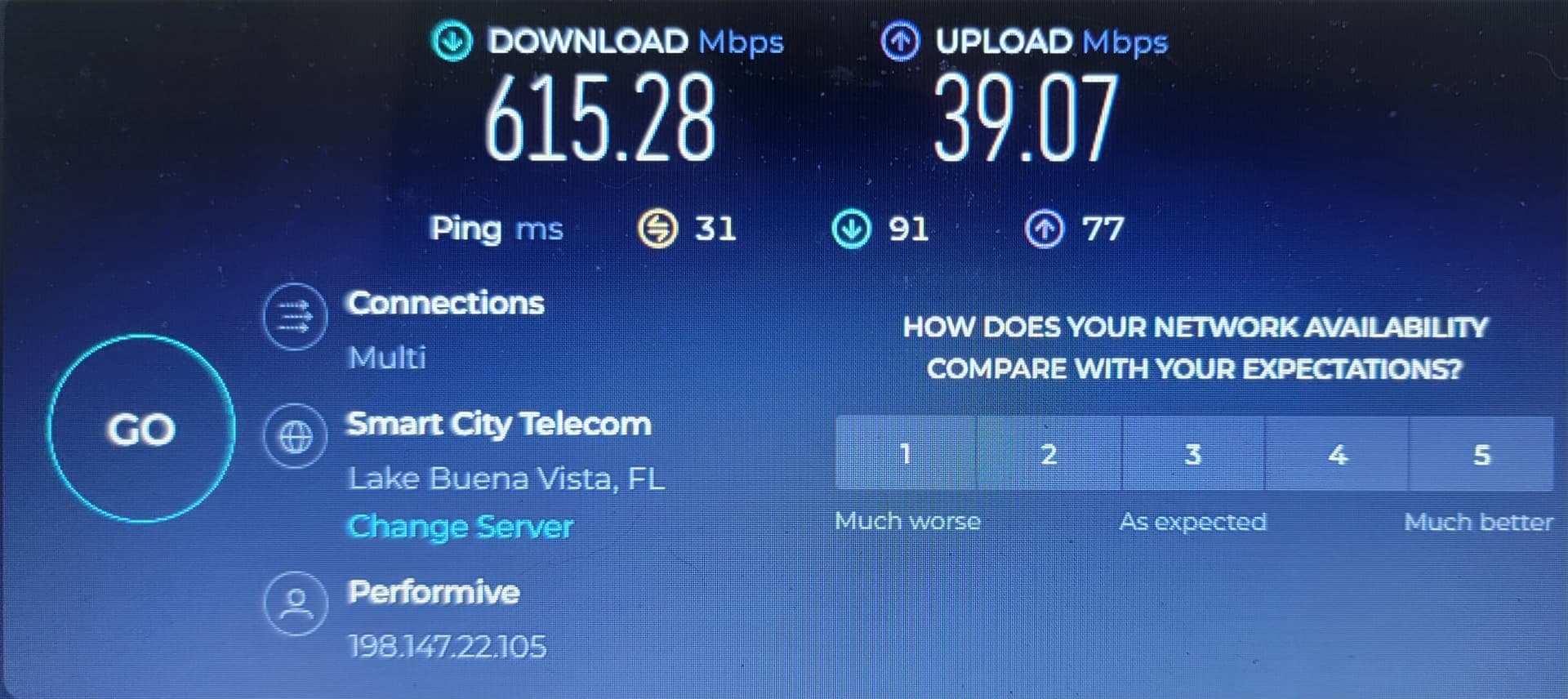

Miki, the speeds you listed, are they with a VPN or not? I get ~ 250+ on my FS4K with Surfshark VPN disabled, and 30+ with it enabled. Your speed sound right without a VPN, but if they are with a VPN, what VPN were you using?
I forgot to mention this, but the speed drop is only on my firestick. Running vpn on my computer is almost as fast as without.
I guess that is what makes it all the more annoying.
Results:
456.8 computer no VPN
442.6 computer with VPN
313 Firestick no VPN
35 Firestick with VPN
Robini, like you, I also get 300+ Mb/s with Surfshark enabled on my laptop and only 1/10 of that on my FS4K. I’m not really complaining, since 30 is more than adequate for streaming. I only chimed in to try to explain my theory as to why the FS was so much slower than the laptop, with both connected to the same WiFi network.
I agree with your statement regarding the WiFi antennas. However, without the VPN, the FS speed, while lower than the laptop, is still over 8X the speed of the FS with VPN, whereas the laptop speed is virtually the same with or without the VPN (same WiFi network, Surfshark VPN, and VPN server location).
