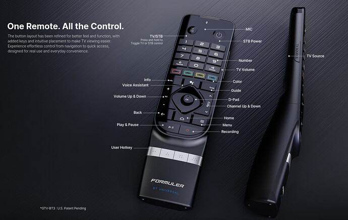

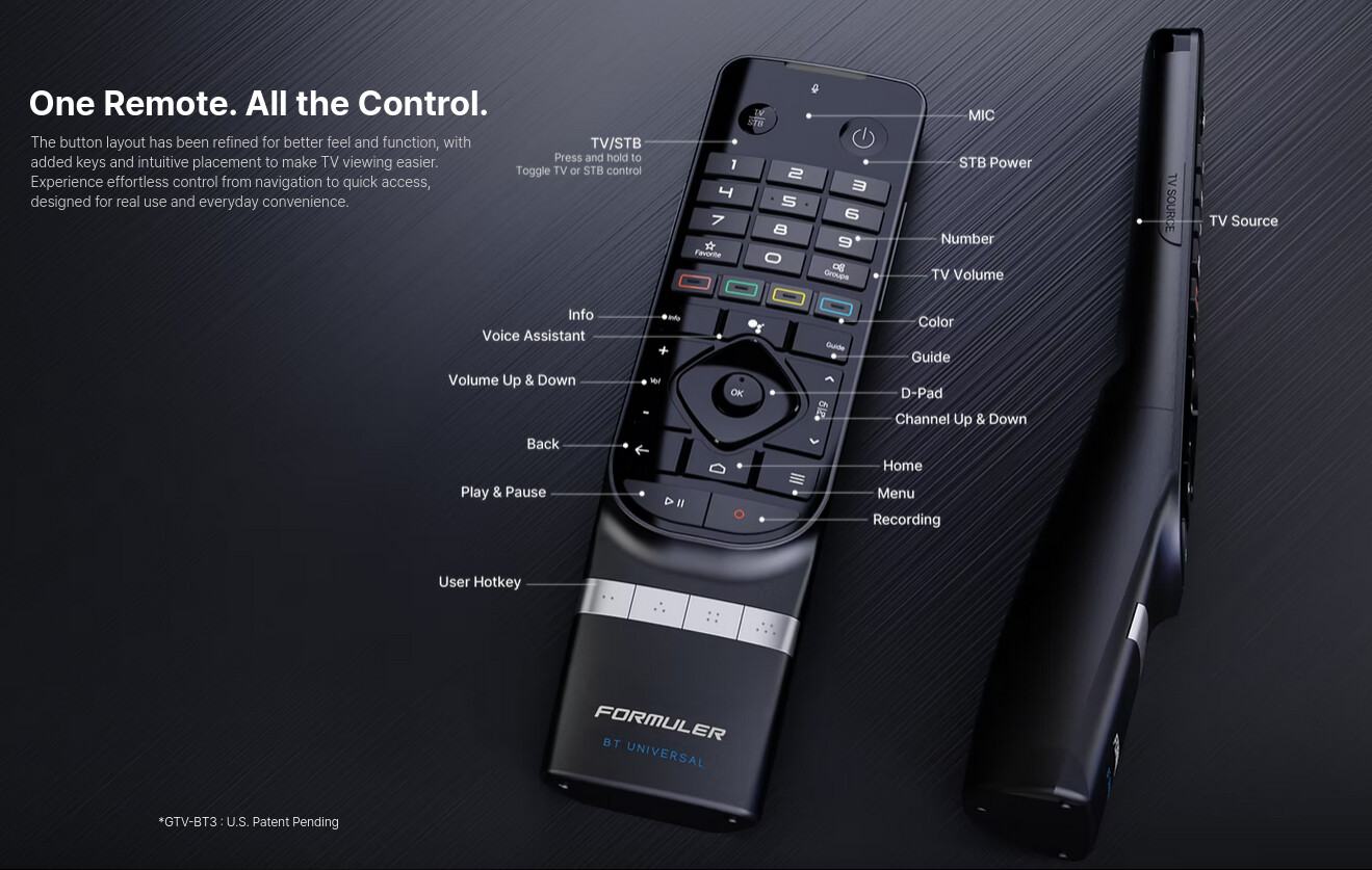

I certainly learned my lesson the hard way not knowing that an out of country location would brick a Formuler device. Never gave it a thought of the location I was hooked to when I began updating the software on it when I first fired it up. Maybe one day I can find out how to unbrick it if I can connect with the right person who has the the instructions on how to do so. I ordered my Z12 Ultra from Amazon day before yesterday & had it yesterday so I got it in 1 day. I got all the updating of the software done, loaded a boatload of apps in to it & then things got super sour! Upon an update for the BT3 remote which if I remember correctly was 2.0.2 I hit a wall of remote function failure. Although I had set it to my tv to control the sound with the tv control, but it refused to switch to it stuck on using the system sound. Interesting also is that it has a 0-25 volume bar like a cell phone up the right side instead of the prior Z11’s blue bar on the center bottom. I tried the manual pairing with the tv remote head to head, tried the IR remote from my Z11 Pro Max, & about every thing else, rebooting, whatever I could think of yet it won’t work to correct the problem. It worked fine before the update so it’s got to have something to do with the remote update causing trouble. So I hit the dreaded factory reset losing about 4 hours of hard work setting things up, & yet the problem still existed. Then I thought I didn’t try the BT1. I got my BT1 remote out that was already set up for my Sony & BOOM! That remote worked! I have no clue exactly why neither the IR remote or the BT3 won’t work when the BT1 does, but I was kicking myself in the tail for not trying that remote BEFORE I done the factory reset. I hated losing all the work I done setting things up, but oh well, wasn’t the first time & surely won’t be the last. If any of you hear anything about this issue please pass along but I figure it will be a wait until a remote app update comes along that will fix it. I do know my Sony’s remote is a RF remote, not an IR remote so it may be a factor somehow. I have a 2022 Sony in the bedroom that is the very same 90 series Bravia & mine is a 2023 series 90 bravia of exactly the same other than the year & the remotes for the 2 will not cross each other, either one will not work the other tv. With them being RF I guess that is a good thing so I am not tripping my wife’s to get my A$$ thrown in the doghouse messing hers up! :joy:
Don’t forget You may have the remote with two sound keys. On on the left face and the other is on the right side of the remote and I mean on the side not the face and if you have the silicone cover it’s very hard to see.
Hey thanks Mike! Man my heart sunk when I seen these hidden buttons. They are really more underneath too. These buttons are extremely uncomfortable to use at all even, plus like you said, unmarked & well hid by the silicone case. I put the batteries in and slid it right in the case never noticing the extra buttons. Now the weird thing is why in the world did they put tv volume buttons on the right side with the system volume being controlled by the top regular volume up/down buttons? They must have been smoking some pretty good weed when they designed it like this! :joy: I don’t mind having the extra system buttons, but those should be on the side of remote for system, not on top. My heart sunk thinking back on all the time I wasted on the app installs over this. I don’t know if there is a way to fix it but that sucks! Thanks again man!
Hey you are most welcome. I spent about 2 hrs trying to get the damn Z12 to control my Samsung equipment and especially the volume I completely gave up and then took a look at the remote button map and went wtf where are those damn volume controls that show on the right in it’s picture. So I took a real close look and went WTH is this? Two volume controls on one remote. They must have way higher thc stuff than I do. Damn they must have been bloto. I only found this out after I disconnected my Z12 and threw it in a drawer. Haven’t hooked it up since. I may one day but I may not. :face_with_spiral_eyes:
Hey Miki. It’s like a fight with the wife. Sure you’re mad at the Z12 right now, but you’ll get over it and get it out of the box again. :rofl: I’m using mine as a backup to my AM9 as the Z12 has a bit more brightness than the AM9 when HDR is enabled.
I couldn’t stand the color of that cover so I removed it right when I took it out of the box. I agree, what in the heck are they doing putting that volume rocker on the side of the remote…terrible!

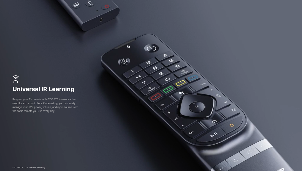

How to program a button
  1. Press and hold the TV button on the GTV-BT3 until the small LED light starts blinking.
  2. Press the specific button on the GTV-BT3 that you want to program (e.g., the power button).
  3. Press and hold the corresponding button on your original TV remote.* Release both buttons when the LED on the GTV-BT3 stops blinking and turns solid, indicating the code has been learned.* Repeat this process for each button you wish to program.
Yup that’s one of the button map pics I found. Note on the right side the little direction line with a dot ends on the face of the remote. That’s not where it is located. I am a super fussy person and absolutely abhor inconsistencies and especially from makers of equipment but in particular from engineers. Testing ? What testing? Throw it out to the masses they’ll figure it out. :face_with_peeking_eye: :face_with_spiral_eyes: :jack_o_lantern: Unfortunately mine would never control my system no matter what way I tried, even after the update that added Samsung codes.
Man it wasn’t funny with all the time I spent loading apps in to it & then factory resetting it not even knowing those buttons were there, but at least I am not alone to be bitten by this very stupid mistake. I don’t even use it. I am using the BT1. Formuler really had their head in their rear on this one! At least all of this up here now for others to read may save somebody else from having it happen to them.
