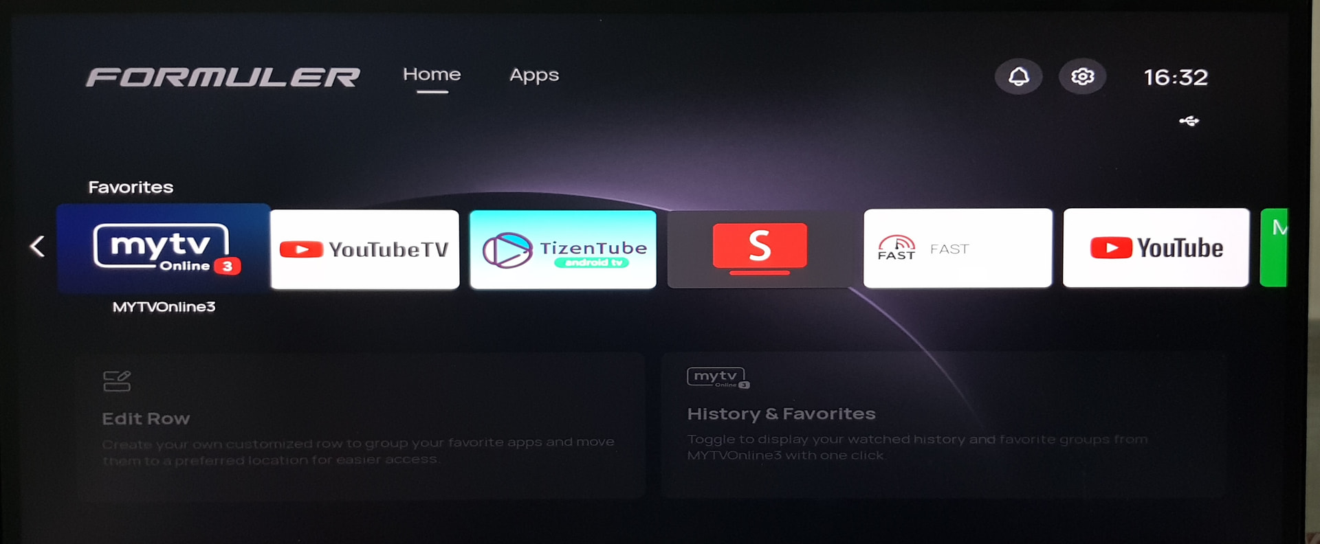

@Kyboy You also might try SmartTube as well. TizenTube and SmartTube are in the Troypoint Toolbox.

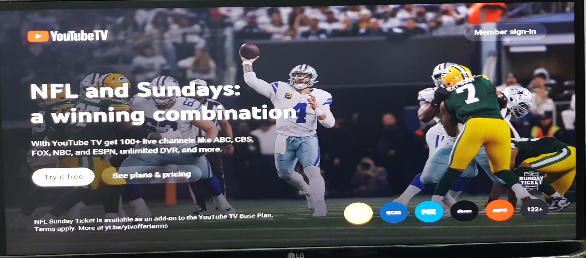

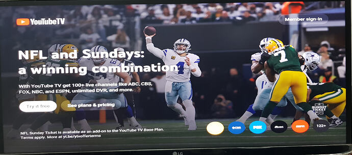

Thanks for the info but I have both of those apps. It’s the Youtube Tv app for streaming live tv that is the problem. I’ve seen all the post for the YouTube app (which doesn’t work either) but nothing on the YouTube Tv app. It was working fine until recently. However it works on the devices I put in my post. Must be a Formuler issue. They may be trying to force people to use their “mytv online 3” app. Anyway thanks for your reply.

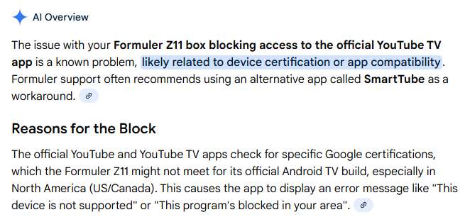

Don’t have a Formuler Box but a Google search returns this at the top:
Thanks. I have the Smart Tube app and it works. But I have a subscription for YoutubeTv for live tv streaming. Apparently something may have changed with a Formuler update that may have changed the certification or something. The YoutubeTv app was working until now. I hope the Formuler support team will correct this. Thanks again.

I had the same version but not working. Uninstalled updates which took it back to version 2.13.08 which is still not working. The app I’m really concerned about is YouTube Tv. Not YouTube. They are two different apps. YouTube Tv is for streaming live tv. YouTube is for streaming videos people upload. Thanks anyway for your help. I’m hoping Formuler can resolve this issue.
