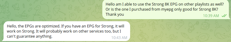

I did answer your question. You can use any EPG you want, but the TVG-IDs may not be the same across different providers. If they don’t match, you will have to manually assign each channel to the matching one in your second EPG.
If you’re asking if the TVG-IDs are exactly the same in Strong8k as they are in whatever other provider you are using, there’s no way of knowing that.
@Miki I asked your question on their Telegram. Here is the response: You can always do the Free trial and see. No credit card required for the trial
