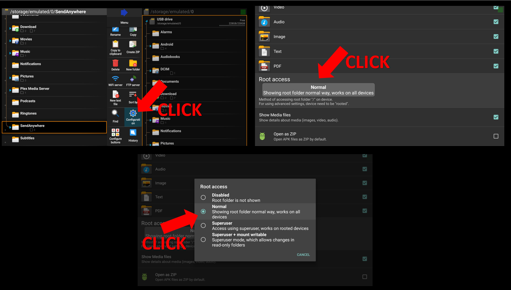

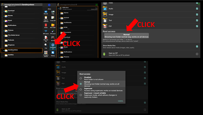

Thanks Powerfader. I set configuration to “normal” and it went away. Something I don’t have to worry about anymore. Still no “picker” and can’t create a Tivimate folder in Xplore. Seems I’m not the only one. Could have a bad flash drive? Think I have a small 16 gb drive in the drawer…maybe I’ll try that one. Thanks for the help. At least I’ve learned something.
