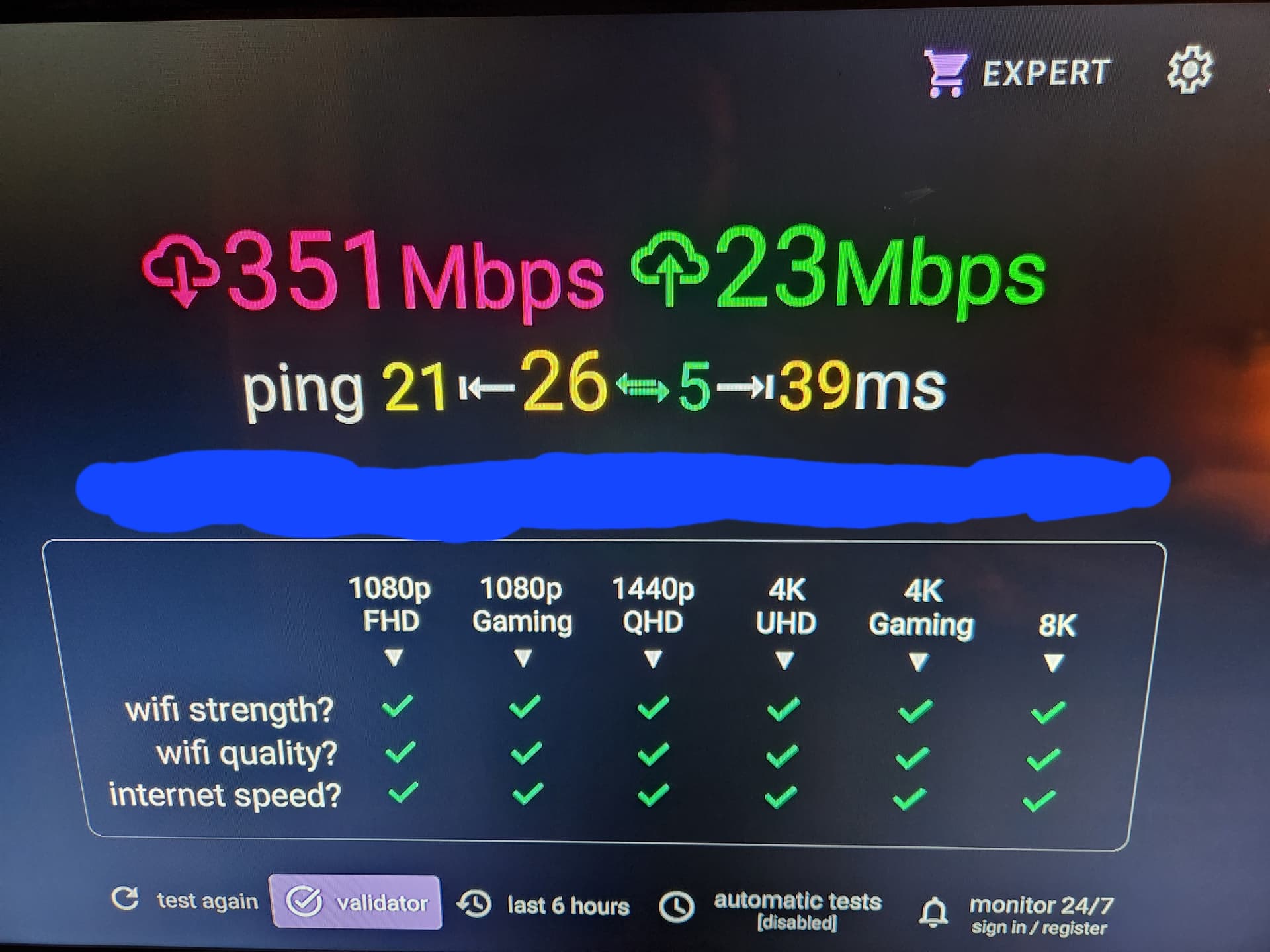

My KM6 Deluxe speed test on wifi, in the room directly above my front room node of my mesh wifi. Probably around 15 feet away from it. My internet service is 500Mbps, this test is without VPN.
