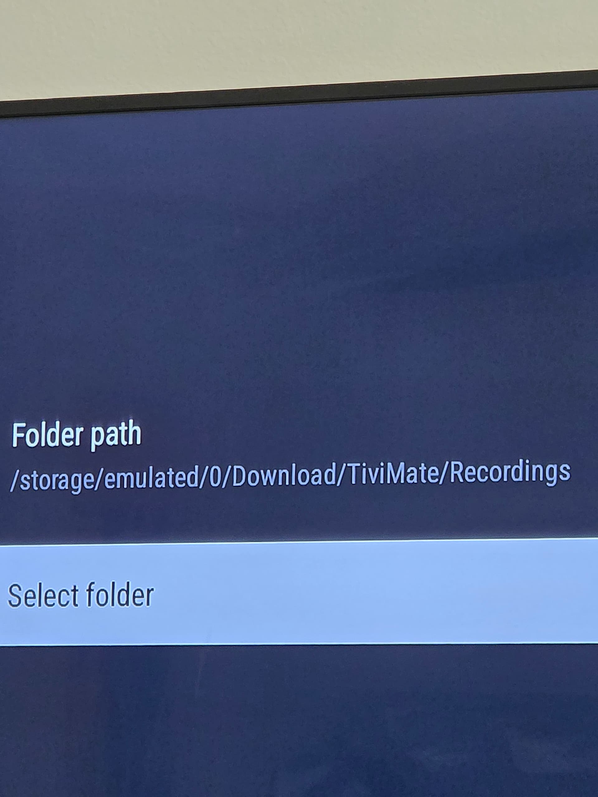

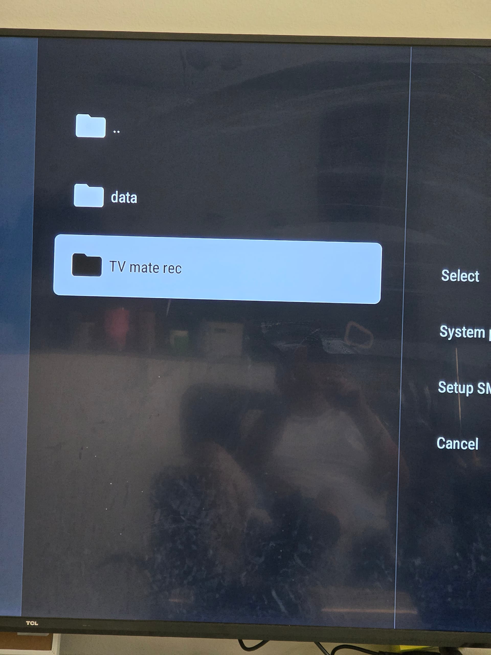

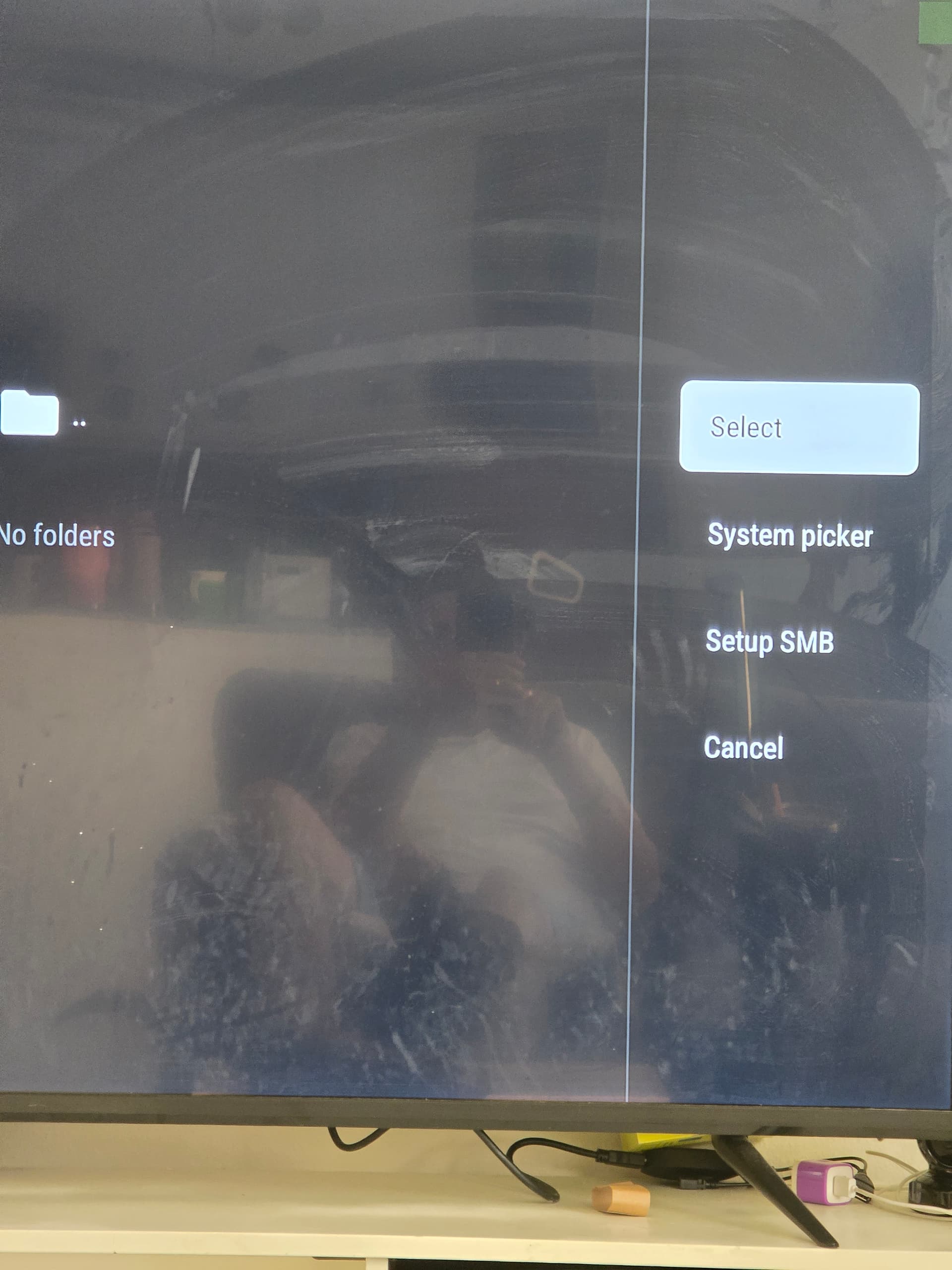

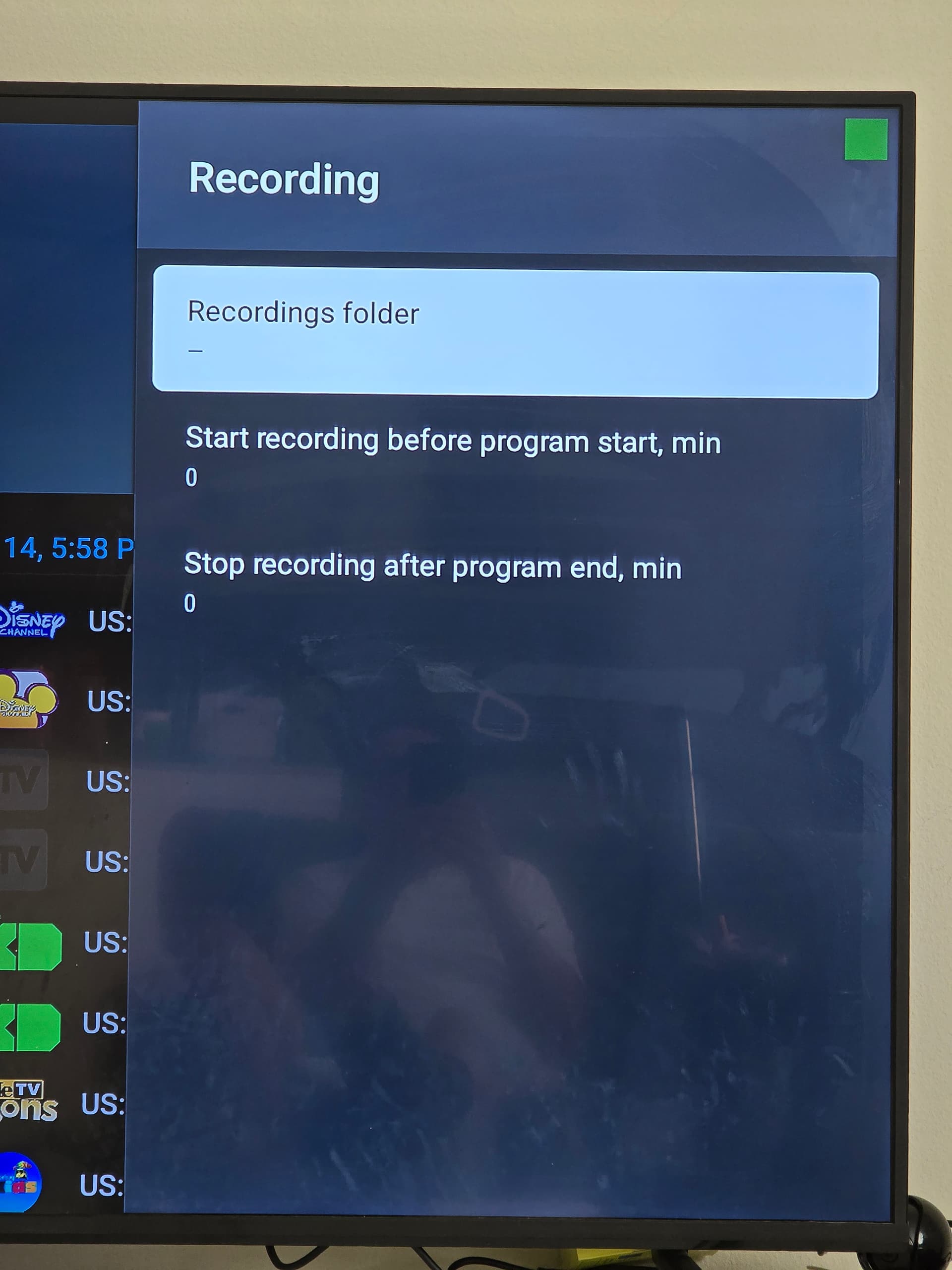

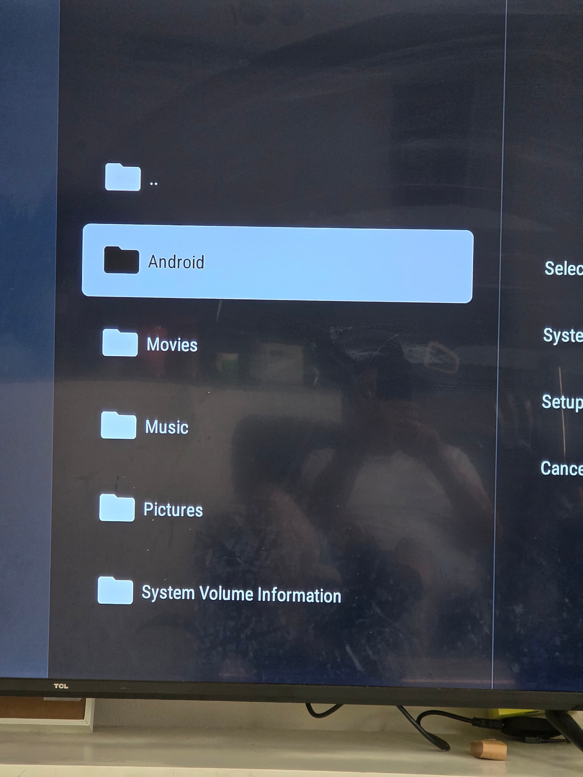

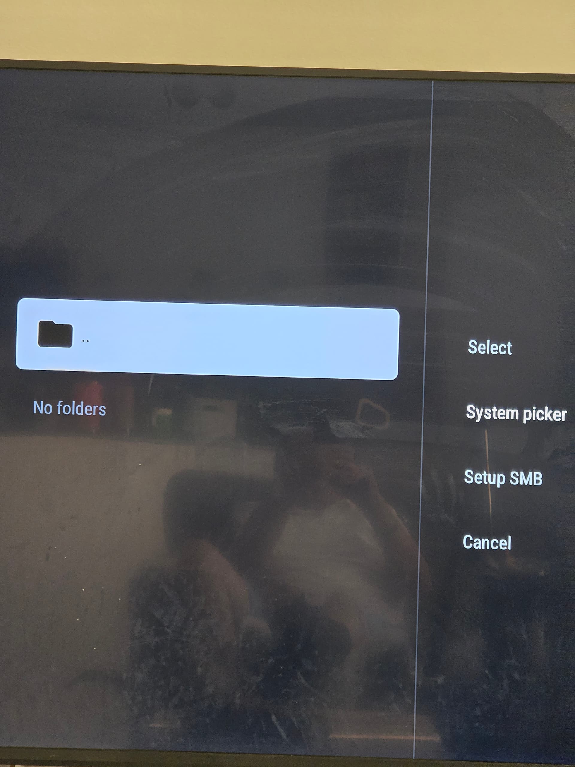

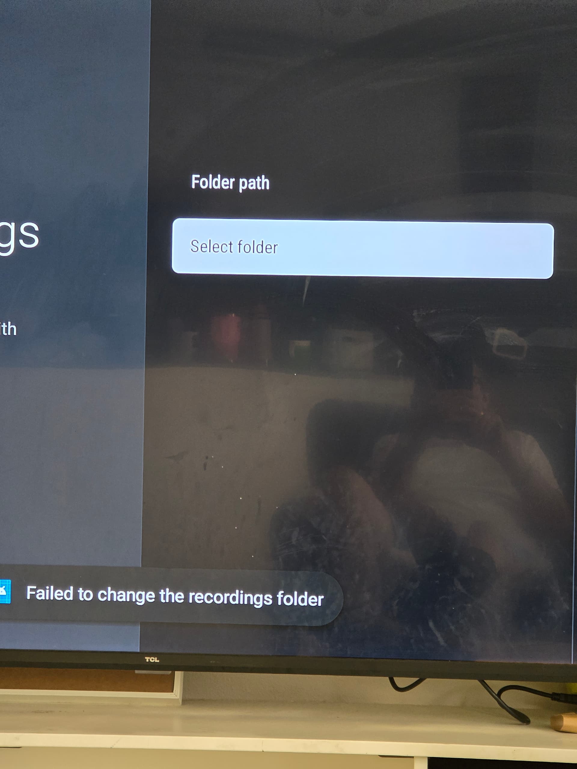

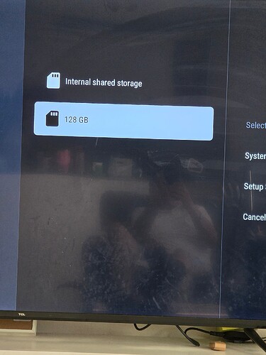

Ok have knocked my head into the wall trying to do it myself, but I’m bout to shoot myself!!! Trying to set up tivimate recording. I erased the recordings folder and tried to type a folder ( tv mate rec) that i set up in xplore. When i last step select that folder> get message @ bottom "failed to change recordings folder"HELP !!! I KNOW I’M CLOSE
You shouldn’t need to type anything in. Do you have the “System Picker” option showing? I don’t have an ONN so I’m not sure what you see. You may also need to find both the Data folder and the OBB folder and click them. Hopefully that activates a permissions popup that allows TiViMate to access them. Sorry I can’t give the exact method without an ONN. With the system picker it should take you to the recordings storage device for you to select that foldwr you made and then you will have to click the “use this folder” down the bottom which opens the permissions to allow TiViMate to use that folder.

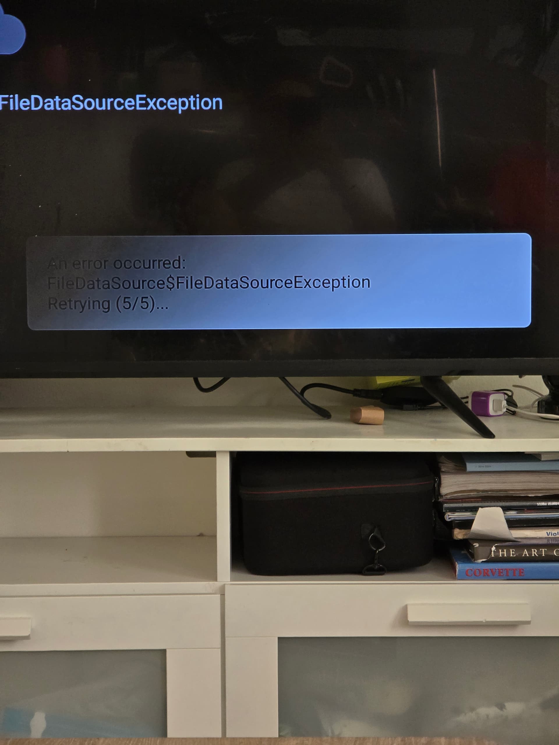

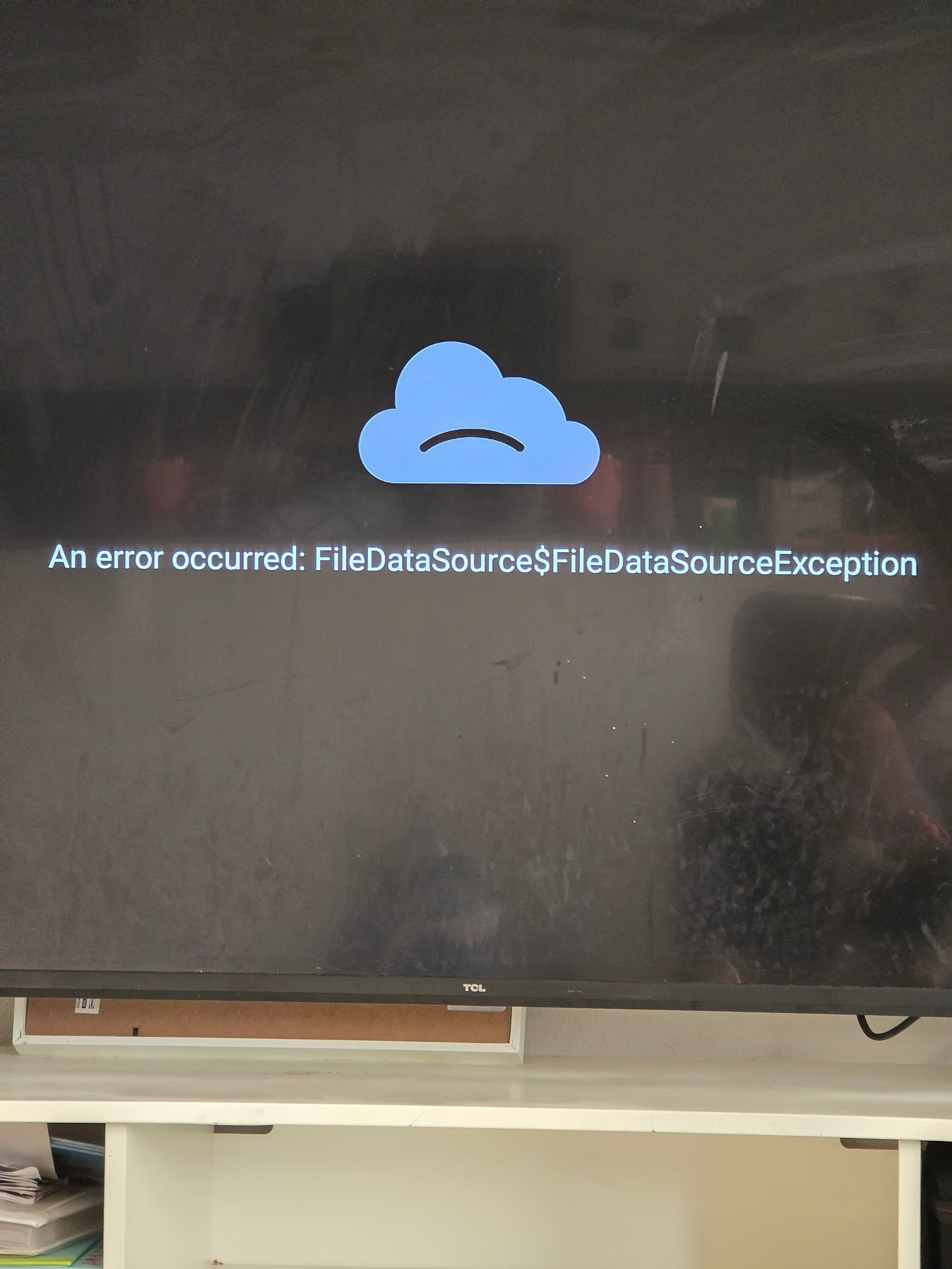

My screenshots during attempt to select a path. When i attempt to play a tec i get the lastmrssage on black screen
