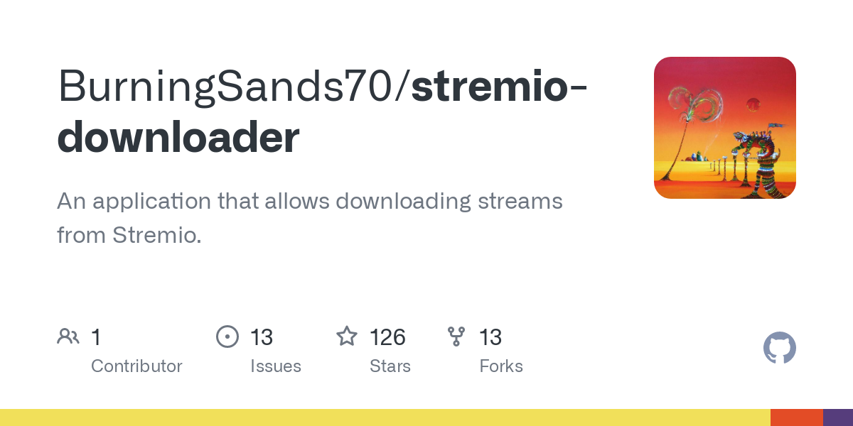

I don’t see any download for this other than Darwin, Linux and W32. Unless I am missing something, I will have to keep looking.
