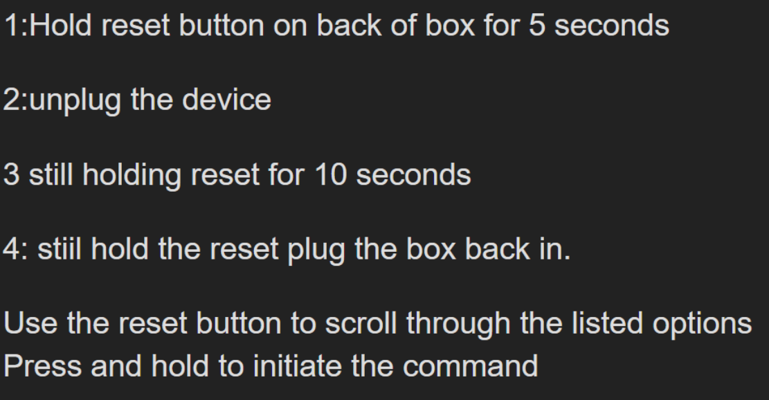

In response to your Dad’s problem, I had a similar problem. If I remember correctly I told Google to go to “setup”. Once there I went to apps, and started Launcher Manager, and selected stock launcher. He can also reset to manufacturer defaults.
I think my ONN is toast! Either the box, or the remote. At anyrate I cannot do anything with it. It boots up to the launcher manager, so I suspect its the remote. Fortunately for my wife, I have a very old firestick that may satisfy her needs.
I have Bricked my ONN to the Black Screen of Death twice from Launchers. Follow the following steps to get to the menu to do a Factory Reset
I held reset for 5 seconds and repaired the remote,. I am able to watch TV.
But, I plan on resetting to factory and starting over, this time without a flash drive, which has caused me the problems.
