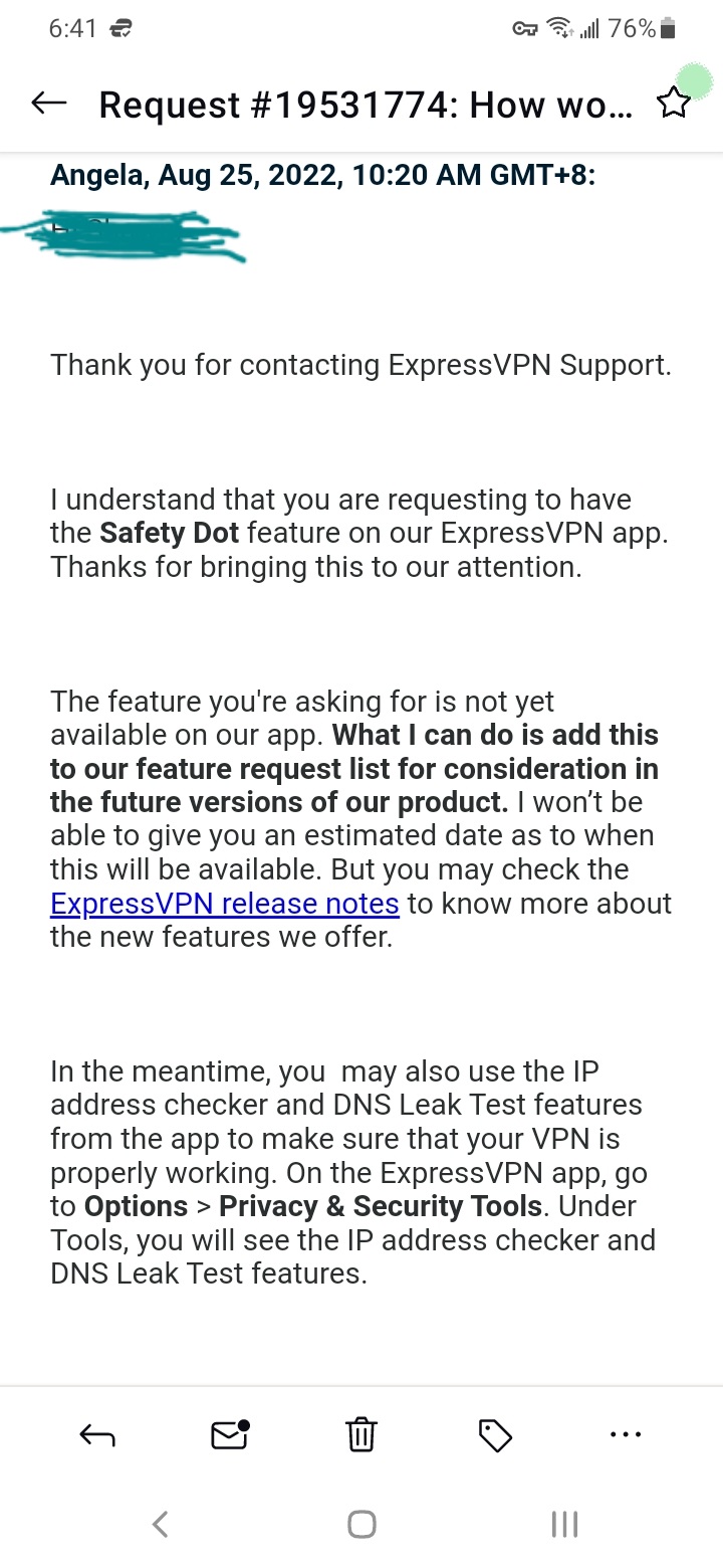

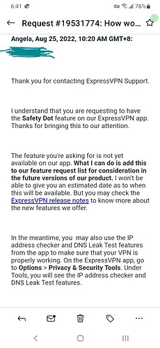

I read this post @TXRon and decided to send an email off to ExpressVPN. This was their reply.
I’m hopeful but won’t hold my breath. :crossed_fingers:
