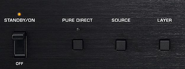

I played around with the settings in my AVR and pretty much agree with your results. I tried pure direct and found that I have to kick up the volume 4-5 notches to match the volume for straight decode. I found that sometimes it (pure direct) will have better sound effects and sometimes not. I also have a buttkicker for my setup and found that both straight decode and pure direct have a more robust response for both the sub and the buttkicker.
