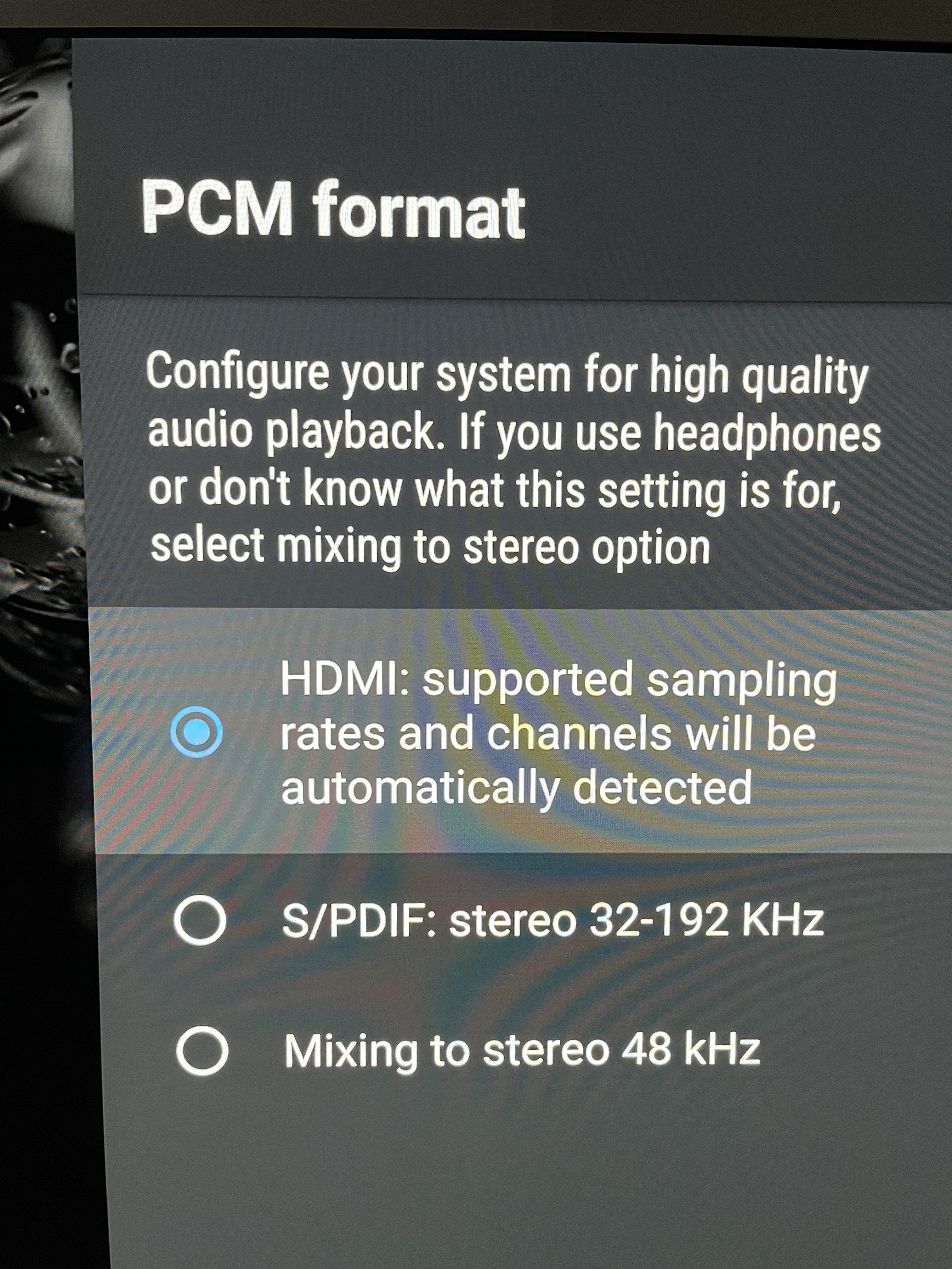

What device are you using? Have you gone deep into the Audio settings and tried say “audio passthrough”?

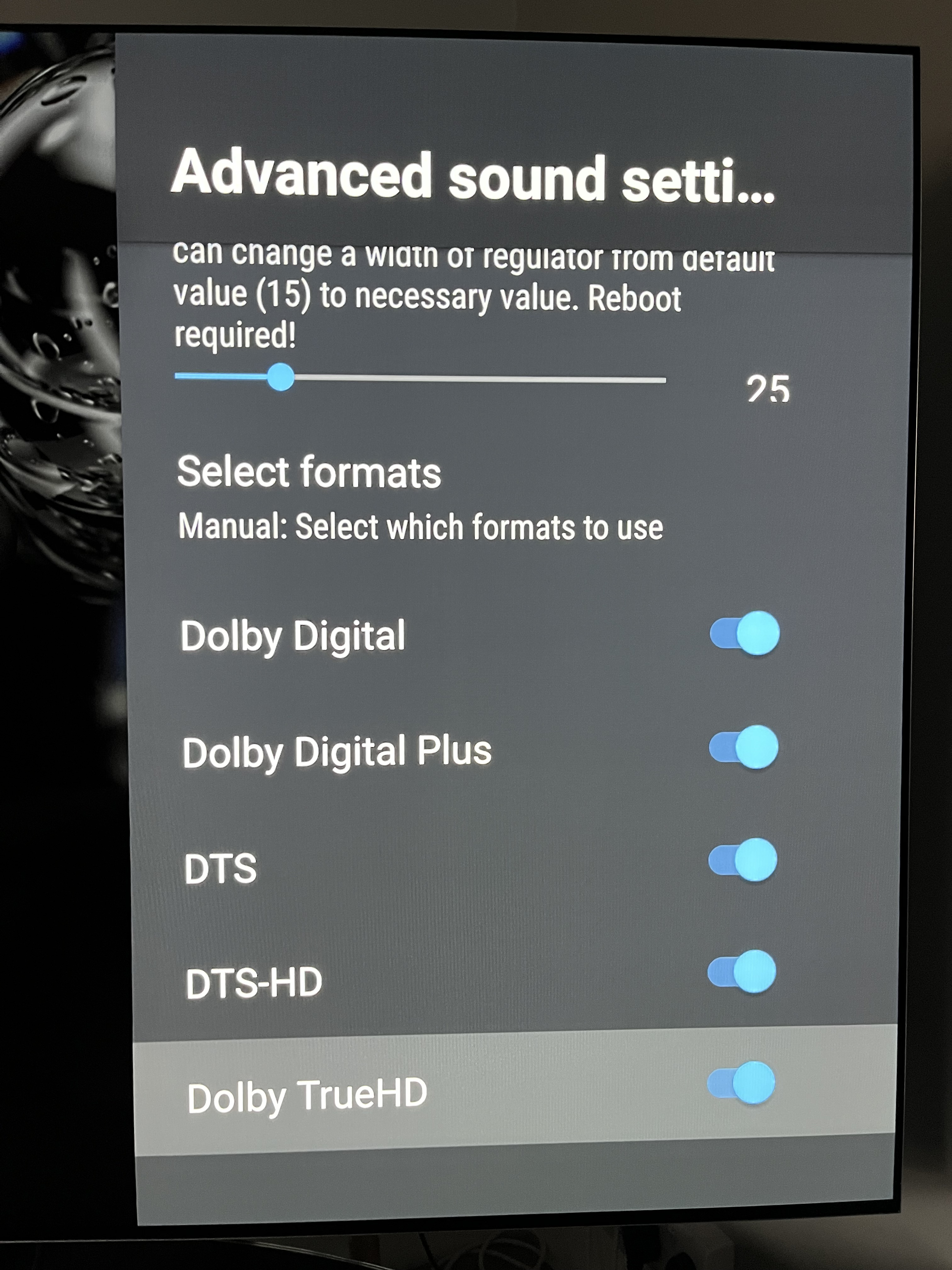

Here are my settings on the latest Ugoos firmware using an HDMI connection and sound over HDMI.
The second pic with advanced sound settings I had to set Select formats to manual because on auto Dolby
True-HD was greyed out but my AVR supports this codec.
You should only enable the ones your Denon receiver supports.
I did try theese settings but for whatever reason my Denon only plays the left front channel. I’m about to give up. I’m sure it would be fine for a non reciever tv but my denon I don’t know what to do.
