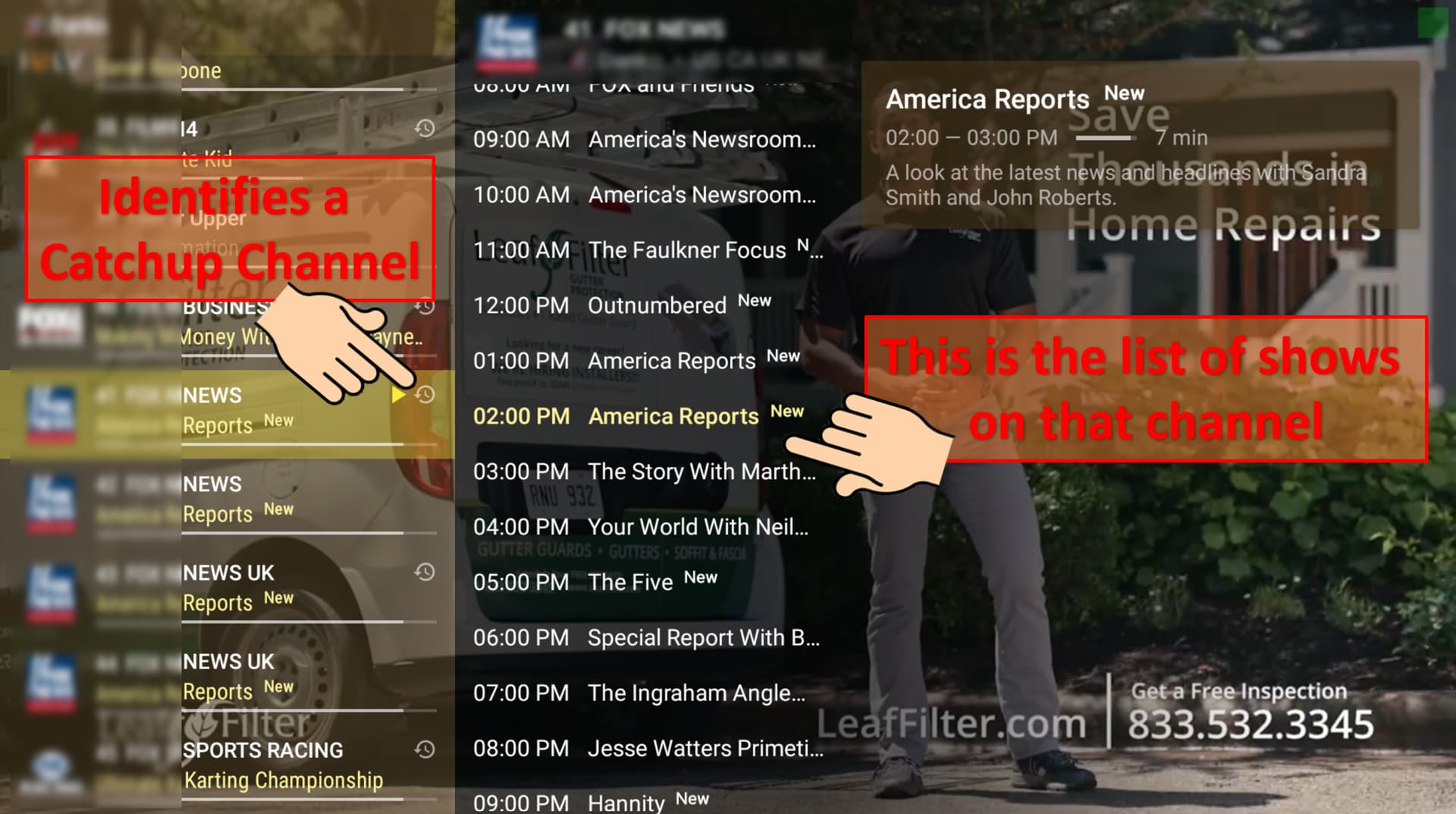

If you see a channel that has the small circle pointing left logo after the name of the channel, it means catchup is available for this channel. Select current show and then long press on the left side of your remote and you can go backwards in time to watch a show you might’ve missed hours earlier.

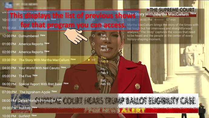

On my remote. I can left click on the directional button to bring up this overlay. Then right click the directional button to display the next page. Here you can scroll back to previous shows on that channel to play.
