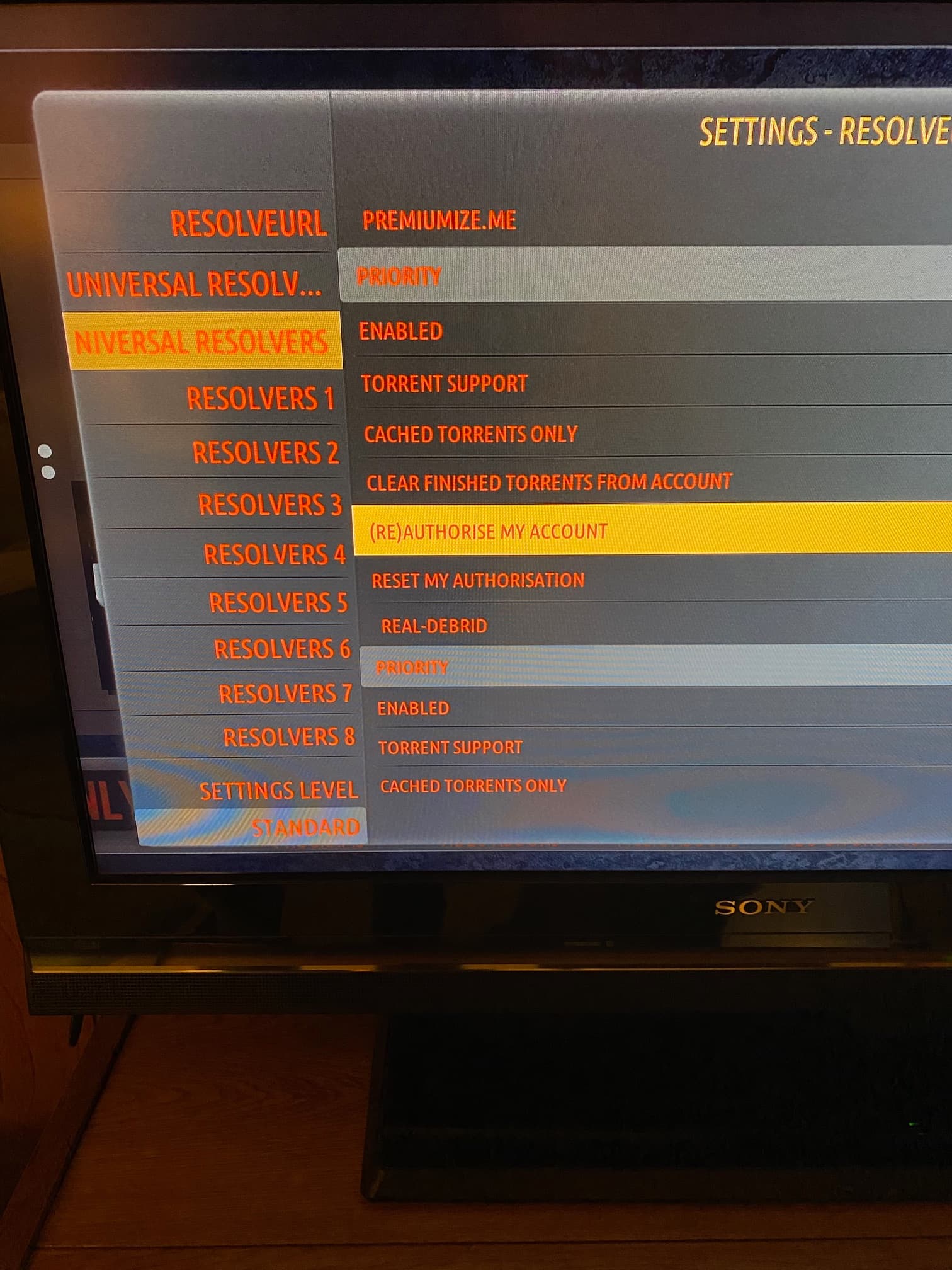

Thank you for responding so quickly. I did scroll down. Again, though RD is in the list …it is off set one space to right and attempts to highlight it fail. RD is skipped over to “Priority”.
Plz see attached image. Notice Premiumize.Me at top. I believe Premium is overriding everything.

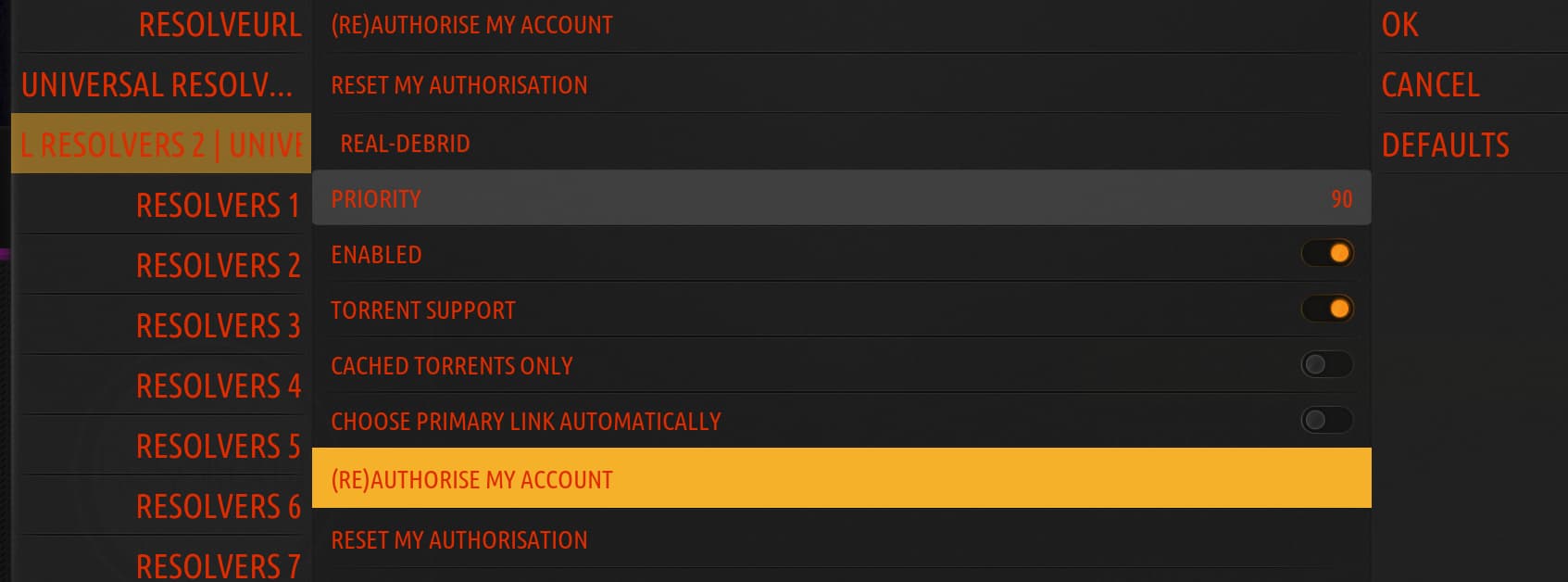

It’s been a while since I used The Crew, but IIRC, the indented Real-Debrid is just a section header. Try scrolling down past the options listed under it to find the option to (Re) authorize your account.
Yup that should do it. This is where you want to be Reathorize my Account in the Real Debrid section
Mark, thx very much. I clicked on Reauthorize. Entered the code on another browser and I BELIEVE all worked as the code entry box closed. This now bears the question…how do I know that RD is now working? Premiumize is still displayed at the top of the screen during the UnivResolver2 view. Again thank you.
If you were watching your KODI screen after typing in the code on your browser you would have seen a brief popup telling you that Real Debrid has been Reauthorized. But easiest way is to play one of your shows or movies in The Crew or other Addon. On The Crew after choosing a stream you will see the Premium sources (RD) on top and the Free sources below. Also all the RD sources will be listed above the Free ones. Premiumize is just another service like Real Debrid. If someone had that service that is where they would authorize instead of Real Debrid. Don’t worry about it you should be all set. Just make a note or calendar Appt when your RD Sub is about to run out as you will not be notified.
