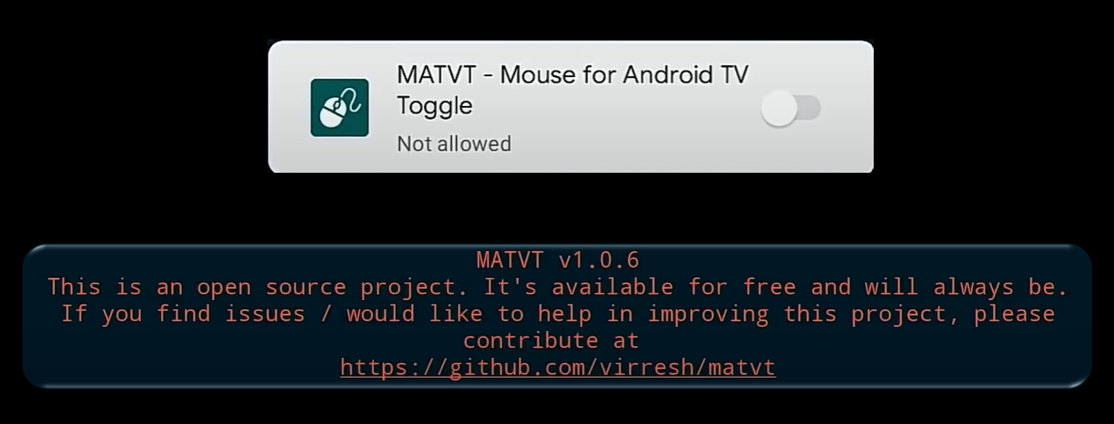

The app I used to install MATVT Mouse Toggle on an Onn 4k Pro running Android 14 is called SAI-4.5. The code to download it via downloader is: 2096948. Let me explain: you need to have the Mouse Toggle app already downloaded on your box so you can search for it later. I downloaded the SAI-4.5 app, installed it, clicked install apk, selected internal file picker, selected download, and there all the apps I installed on the box appeared. I searched for MATVT Mouse Toggle and installed it through that app. I went to Mouse Toggle and followed all the normal steps, and it let me grant all the permissions, and it works perfectly with the TV box remote. Remember, if you don’t know how to grant permissions to the Mouse Toggle app?
