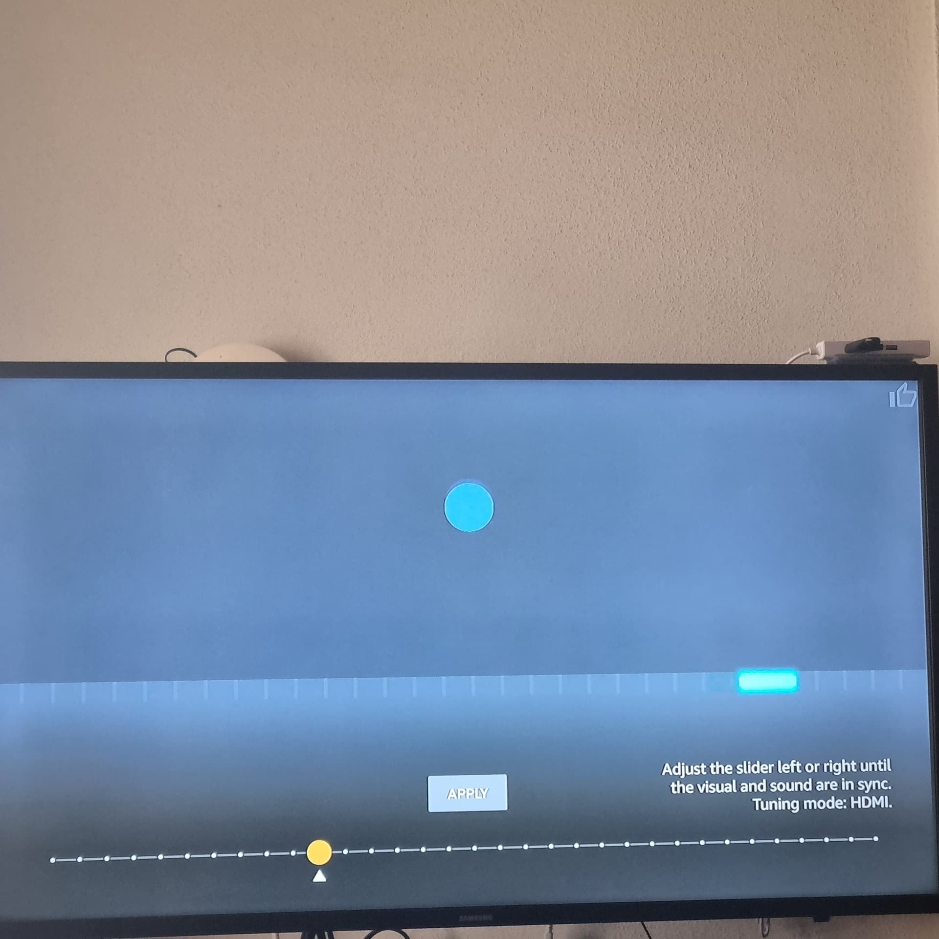

Oh I agree. Another excellent tool I have is a visual AV Sync tuner, that makes it easy to adjust out of sync audio using a visual tool.
Also another handy thing to have…I’ve run into that before myself…but generally had a different server channel to go to till it got back in sync.

Miki, where can I find that sync app? Doing it by ear is rather difficult unless I can find a drummer playing some beats.
