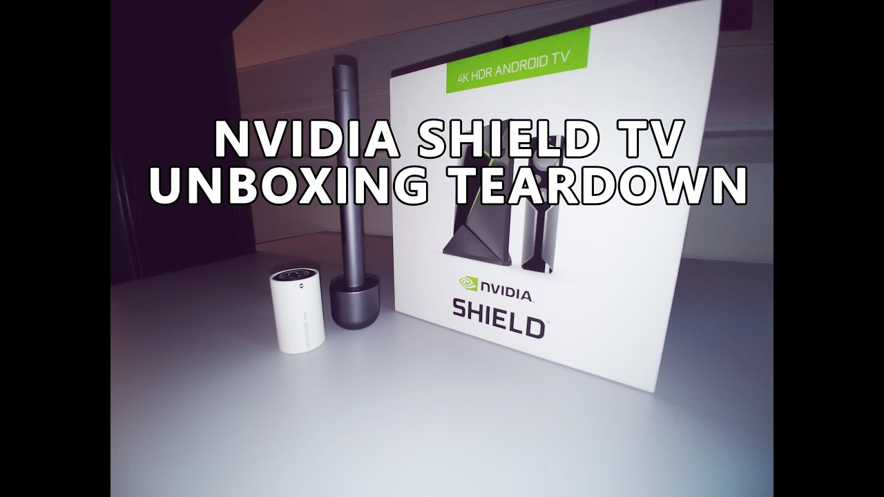

Do you have a link on how to open it? I’m afraid to break it. Is there any way to blow the dust out from the outside? I’m all thumbs as well. What size torx screwdriver do you need?
There is a set of pics on how to do it. Just two small screws and slide the cover off. I’ll try and find the instructions. Maybe on a the shield site.
