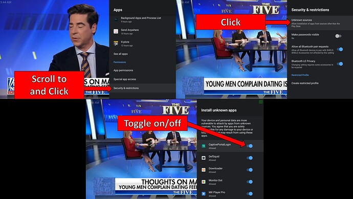

Nobody that I know of here has ever had this issue. There’s always a chance of a bad box, but think you need to try some things before you say it is the device’s fault. Assuming you allowed the installation of unknown apps? That setting isnt default with the Shield.
You have to go into the app settings and allow downloading from unknown sources for each individual app. You have to enable it for downloader specifically. It has nothing to do with the hardware, it’s an OS thing. You also want to turn off play protect. This has been covered in many guides on here for third party apps.
