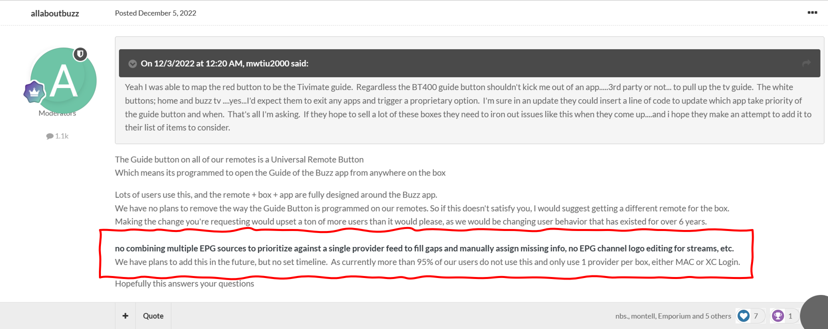

I am now reading some postings on STBTALK which I believe is the BuzzTV official forum. Anyway, this one poster stated that the app does not allow for adding additional epgs and assigning them to other playlists, but not sure.
The attachment is from the mod of the BuzzTV forum. It looks as though the ability to add and assign epgs using the BuzzTV app does not exist yet? However, this post is a year old, but judging from your issue. The BuzzTV team has not yet coded this update at present.

Personally, I don’t like being forced to use apps and especially players. I would go ahead and download Tivimate and see. If it works then your issue is resolved. If the Box won’t play nice with a 3rd party player and you want to stay with that box. Then you are apparently stuck with no ability to add and assign additional epgs.

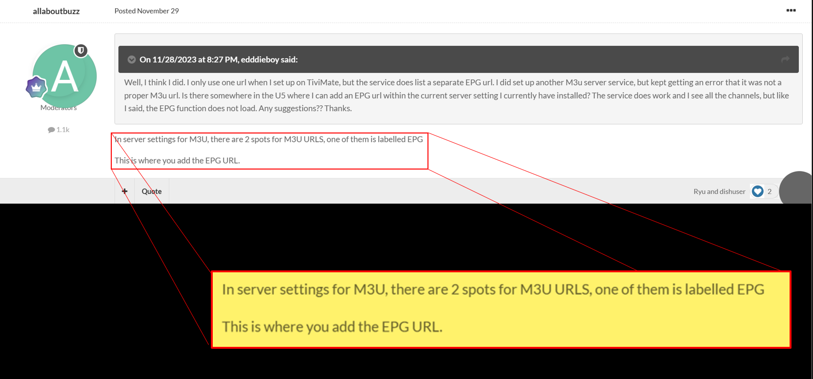

EDIT: I found this post from the mod which was recently posted (11-29-2023)
