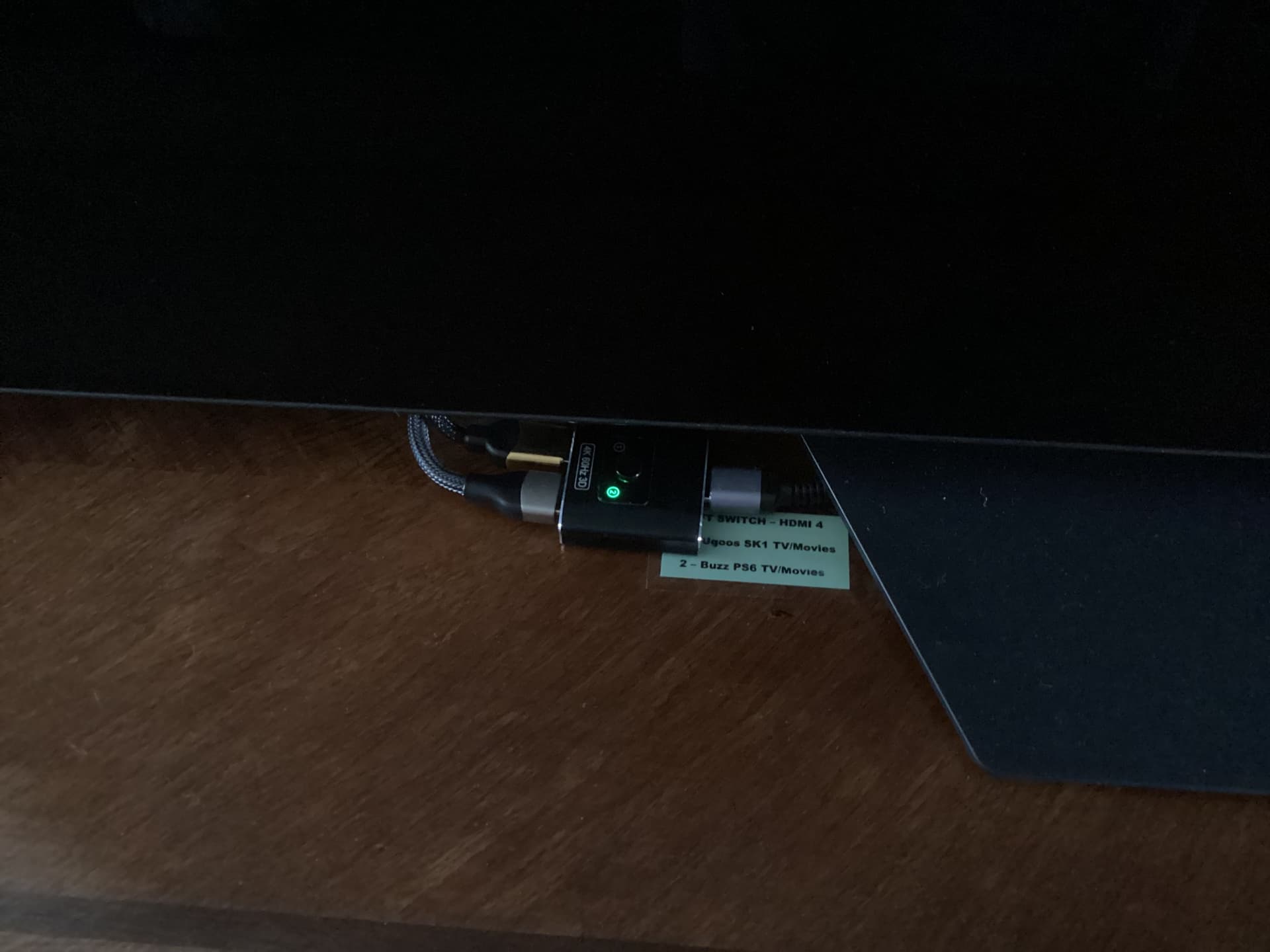

Here is my hdmi switch hookup. I have 2 of these to connect my media player, Xbox console and 2 streaming devices. I tried a couple of 5 port switches with auto switch feature but the auto switch quit on both after a while. I hope you don’t suffer the same fate. LOL
Are those remote operated, or do you have to get out of the recliner to switch ports lol
I get an important and vital part of my daily exercise in if I need to switch the input. Doesn’t happen often though. :man_biking:t2:
lol I hear ya…but when I get in me old recliner in the evening, there is only one thing that forces me out of it…my bladder lol I’d have to have a remote controlled hdmi switch,
I guess the next step would be to get a feeder hose to the closest bathroom. Since mine is only 15 feet away, I’ll grin and bear it. :toilet::toilet:

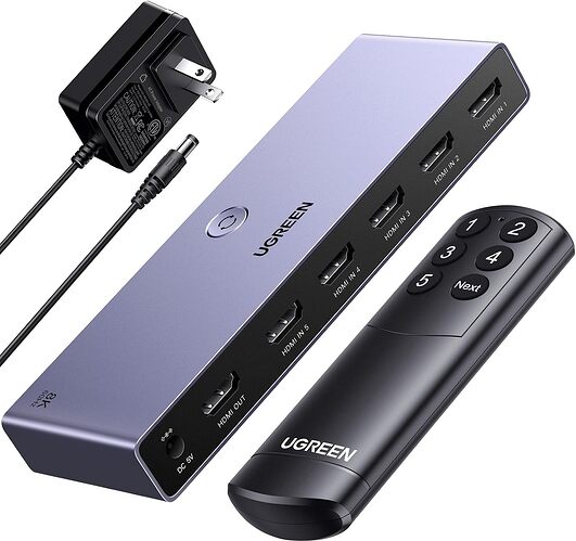

Reece, thank you for the link to the remote switcher. The UGreen looks nice but I found one that is 20 bucks cheaper that might work for me. It come with a remote.
Thanks JerryJ!
Ive had sush great luck with UGreen Products, I decided to be a “Brand Loyalist” when I made the purchase. Hope the ROOFULL works out for you. Be sure and post your results with it so it will help others here in the future!
