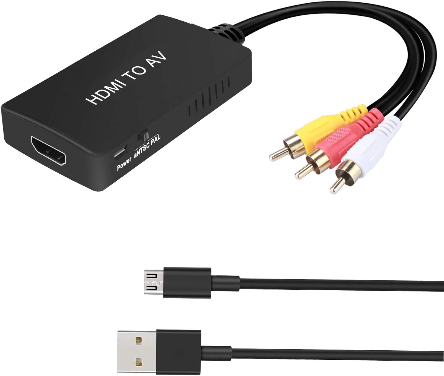

If it has rca inputs just buy a converter.
Here’s a link to some vids that explain how to convert hdmi to analog tv. If it has the inputs on the back of the tv & you want to get one…don’t pay more than around $10 for the converter. :cowboy_hat_face:

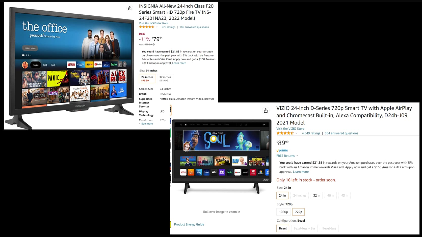

So you can’t connect a Firestick to it. Get him a small flat screen TV or an android tablet and use that. I take it they have wifi there and they’ll let you use it to stream videos?

Y’all are going to think I’m off my rocker here but what about this…I know it is a long shot it would even work, but I hate to give up on a challenge. The Firestick hooks into the HDMI In/RCA adapter. The RCA plugs go into the RCA/RF modulator switch and then a Cable goes from the RF to the same cable post in the back of the analog TV. Set it for channel 3 and voila…maybe? :grimacing::crossed_fingers:
Not really off the rocker stuff :rofl:… if you have rca plugs its a go :grin:
Well thats why I have the two links…2 adapters, working perfectly in tandem? Famous last words. I think I need to sleep it off, I’ve lost it lol. I feel like Marty McFly :rofl:
Probably won’t work. Hospital TVs are usually set to “Cable” channels and frequencies, not “OTA” (RF) channels and frequencies.
Yep…& therein lies the reason for him not being able to change the input…basic cable set up with basic ISP cable remotes. Altho, another thing @Pearlhorse could try is to get a cheap universal remote & sync it to the tv…then when he has control of it, change the input & hook up an hdmi to analog converter. :thinking:

By the time you get done messing around you’ll realize the tablet is the way to go lol. Converting to RCA will reduce quality. Might as well stream everything in 480p. Get a cheap tablet with a cover that doubles as a stand and put it on the bedside table.
Easier and probably less expensive.
