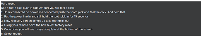

Here is some instruction for resetting a BuzzBox
@bubbadoo read @Powerfader’s post. He is correct. Try the hard reset.
