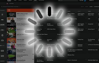

what ever iptv server i use it keeps buffering,can someone tell me what might be wrong on my end thank you.

tried all those still buffers
