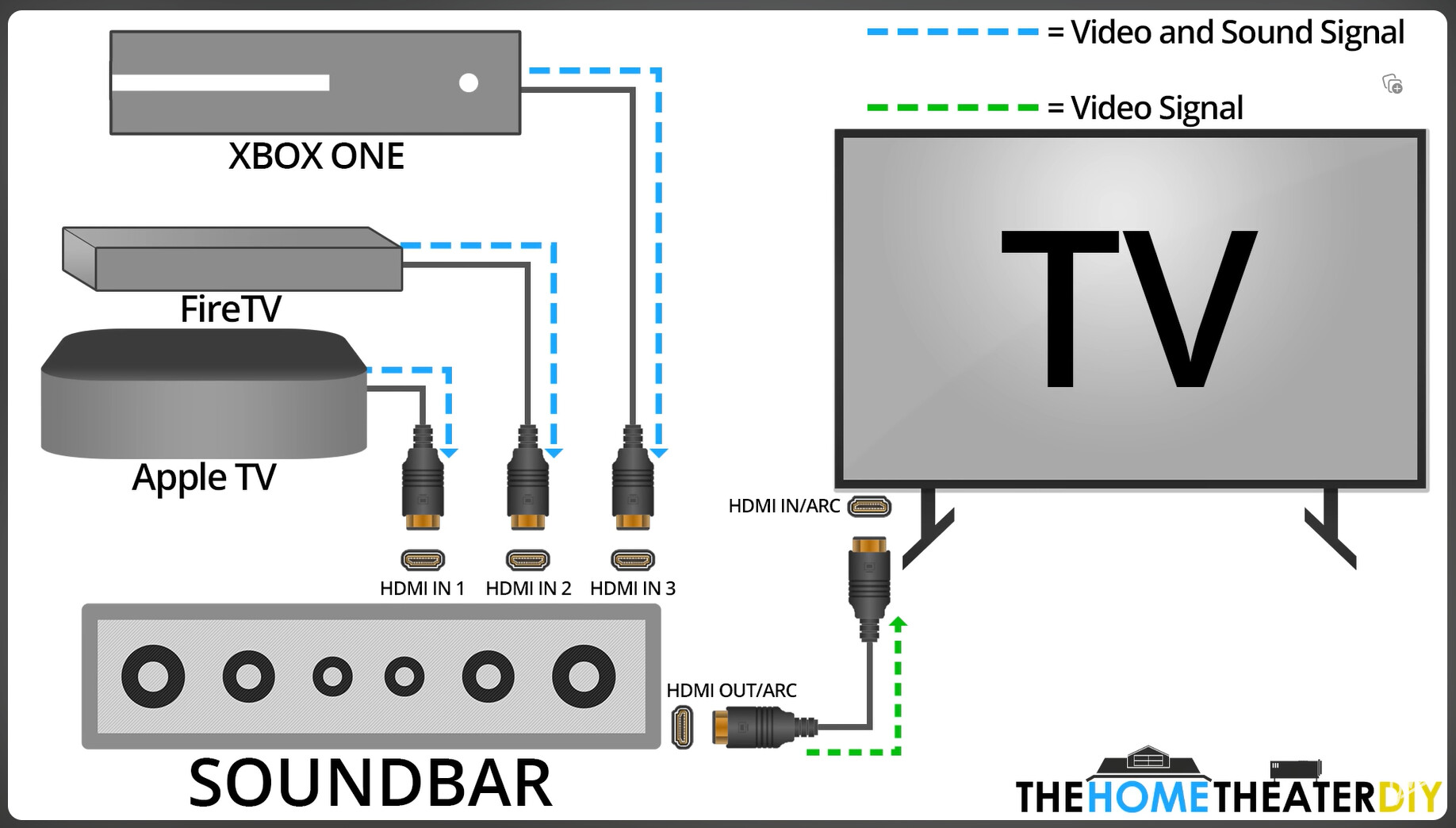

(REG)HDMI OUT to Soundbar → Sound bar HDMI ARC OUT to TV HDMI ARC IN
