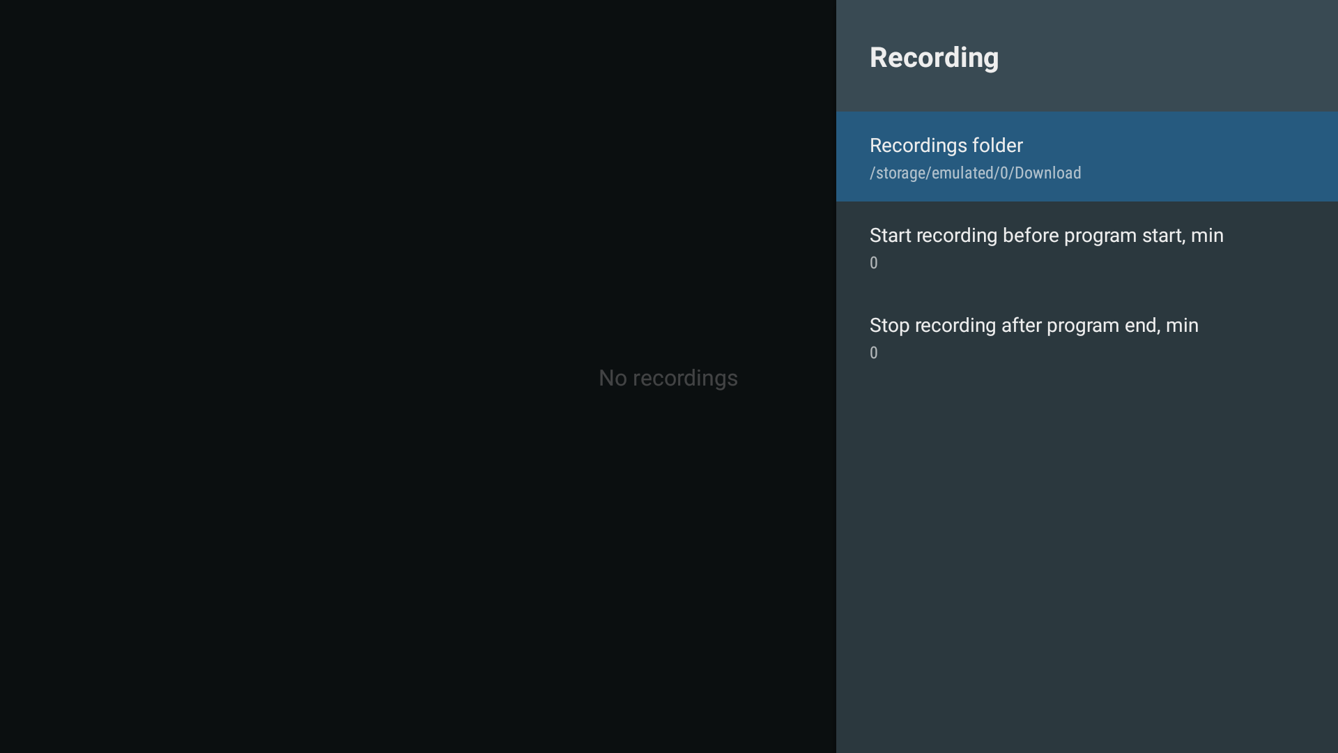

Both Sparkle and Tivimate are recording to drives. One of them is recording to internal, which I have extended, and one is recording to external. There is no system picker in android 14 so forget about using that to obtain write rights to a folder. However, the download folder is open to the user, and I am using that or a sub folder of it for my recordings.
Sparkle always used to record to a sub folder of android/data, which is off-limits on most systems. I hated this, because you do not have easy access to your recordings. However, with the latest revisions, Sparkle has added the ability to choose a folder for recordings. This will only work, however, if you choose a folder with write rights.

Android 13 (Tiramisu) recordings and scheduled recordings work well. I recorded to internal and to an external SSD plugged into the usb 3 . No issues at all.
did you use system picker for tvmate, or what steps did you use?
Yes I used the recording setup in TiViMate. I can do it without the System Picker using X-plore, but most would find it easier using the system picker.
