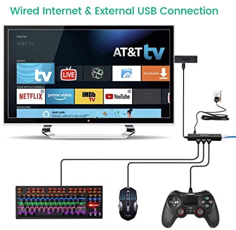

I understand completely, but instead of an ethernet adapter hook it up as in the pictures and you should not have any problems. The hub is your ethernet adapter and your Cat5 (ethernet) cable plugs into the end of the hub.
Would the ugreen hub I listed be the one I need or something different or better. Thank you for the help! The hub you show has the micro USB for the firestick The one I listed has a regular USB output
Hey @jrclay Just an FYI…Troy used the UGREEN USB 3.0 Gigabit Ethernet Hub with USB 3.0 Ports as part of his setup in his 4K Max review. Not sure if it’s the same as what you’re talking about…
Yes, that’s what troy used but it has a USB type A output this one here has a micro USB output which to me would seem to be what I need.

Really wish Troy would chime in because the ugreen would need a USB to micro adapter seems to me.

I have 4 of those smays adaptrs (micro usb) featured in Miki’s post… (using reg 4K stiks)
I use 2 of them wth ethernet wth no probs, (as soon as i plug them in, the stik switches to “wired” cnnctn)
