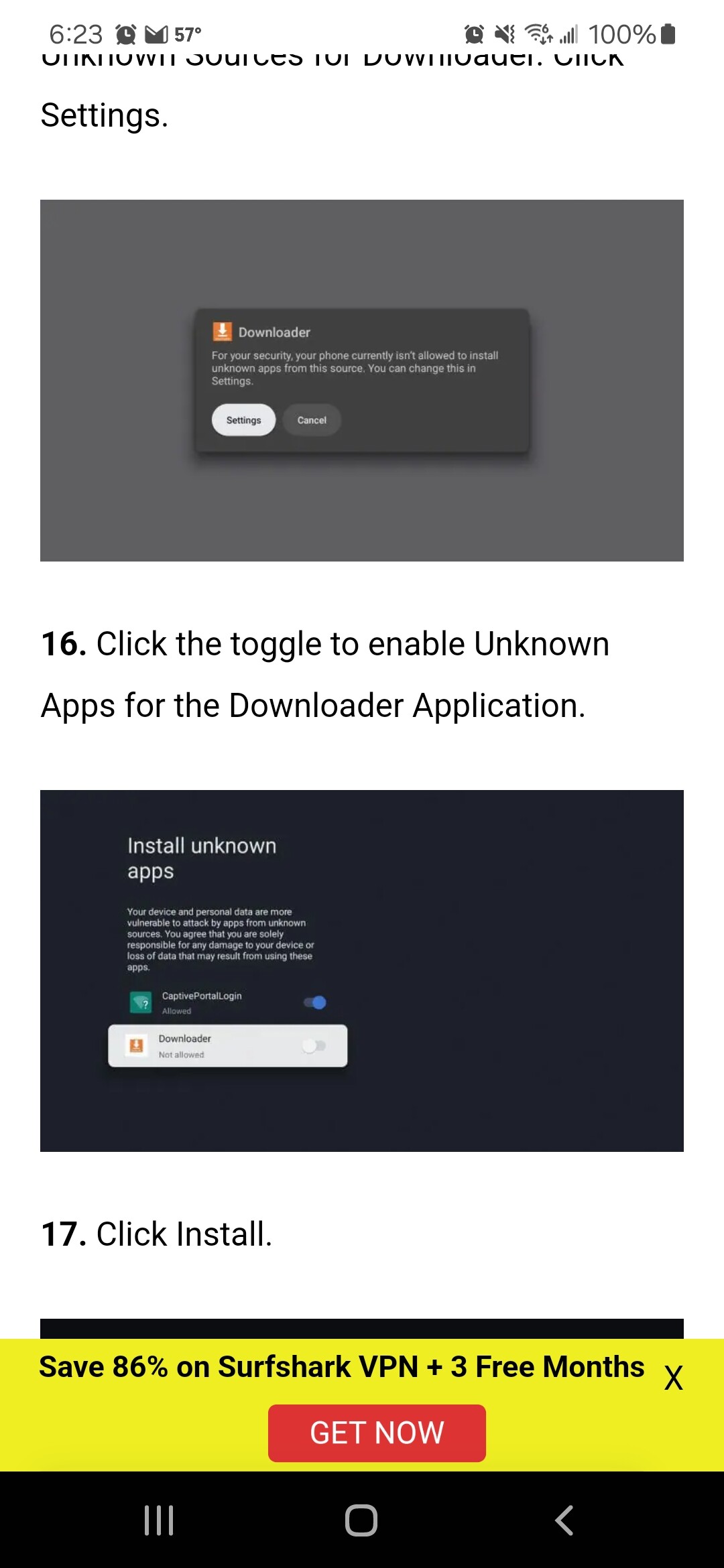

Thank you for the information. I did find this and I think these are the steps I’m missing. I will try it when i get home. Thank you so much for your help.
Perfect, nice find! That is the article I was looking for. Just got home and started looking and saw you replied and already found it. Let us know if it works!

You need to allow the device to install unknown sources from downloader. Follow the steps in the jailbreak article.
