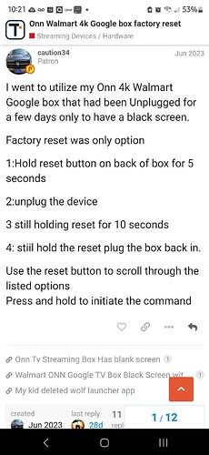

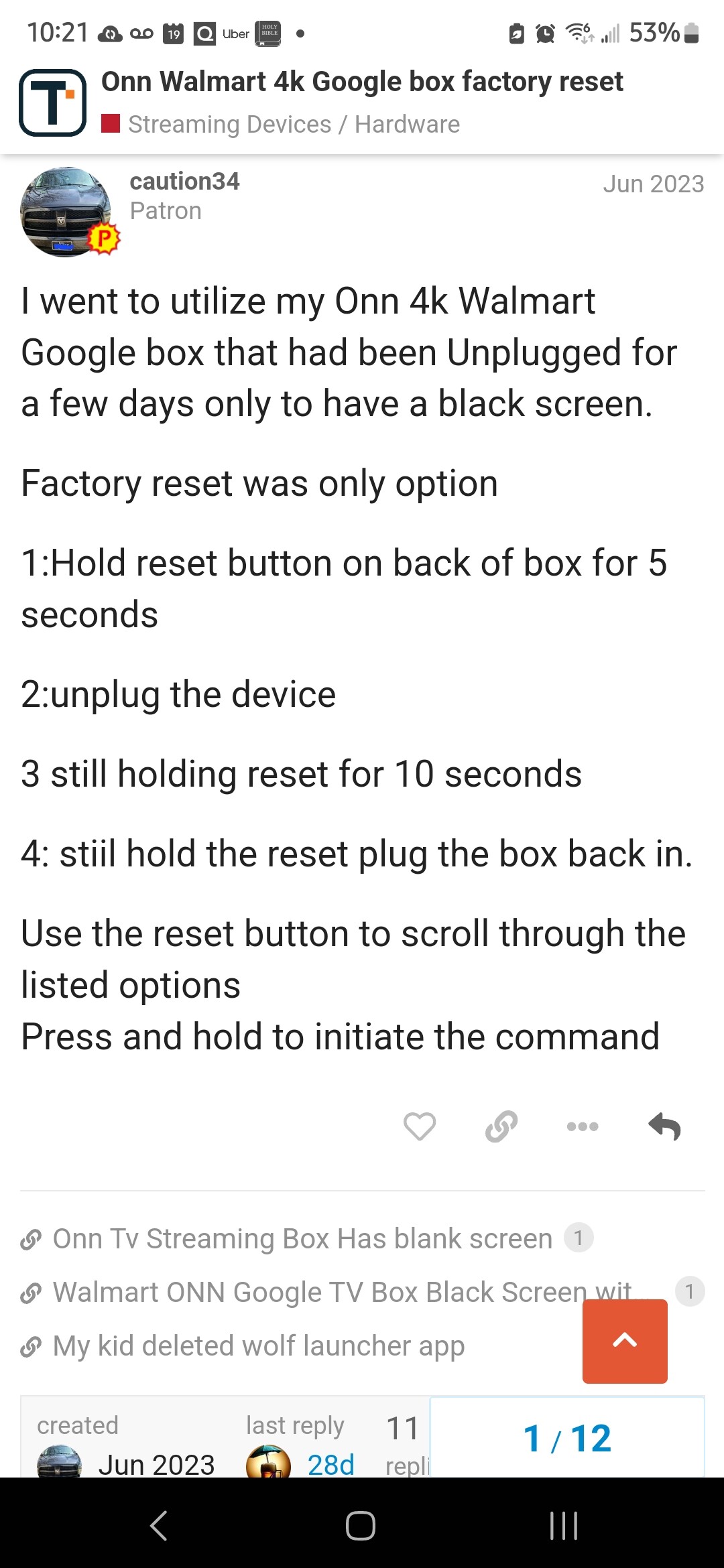

I just reset 1 of my onn 4k , had same issue. Reset to factory n start again. Took me a little to figure how to scroll down to reset to factory n how to select. But finally got it done. Good luck
