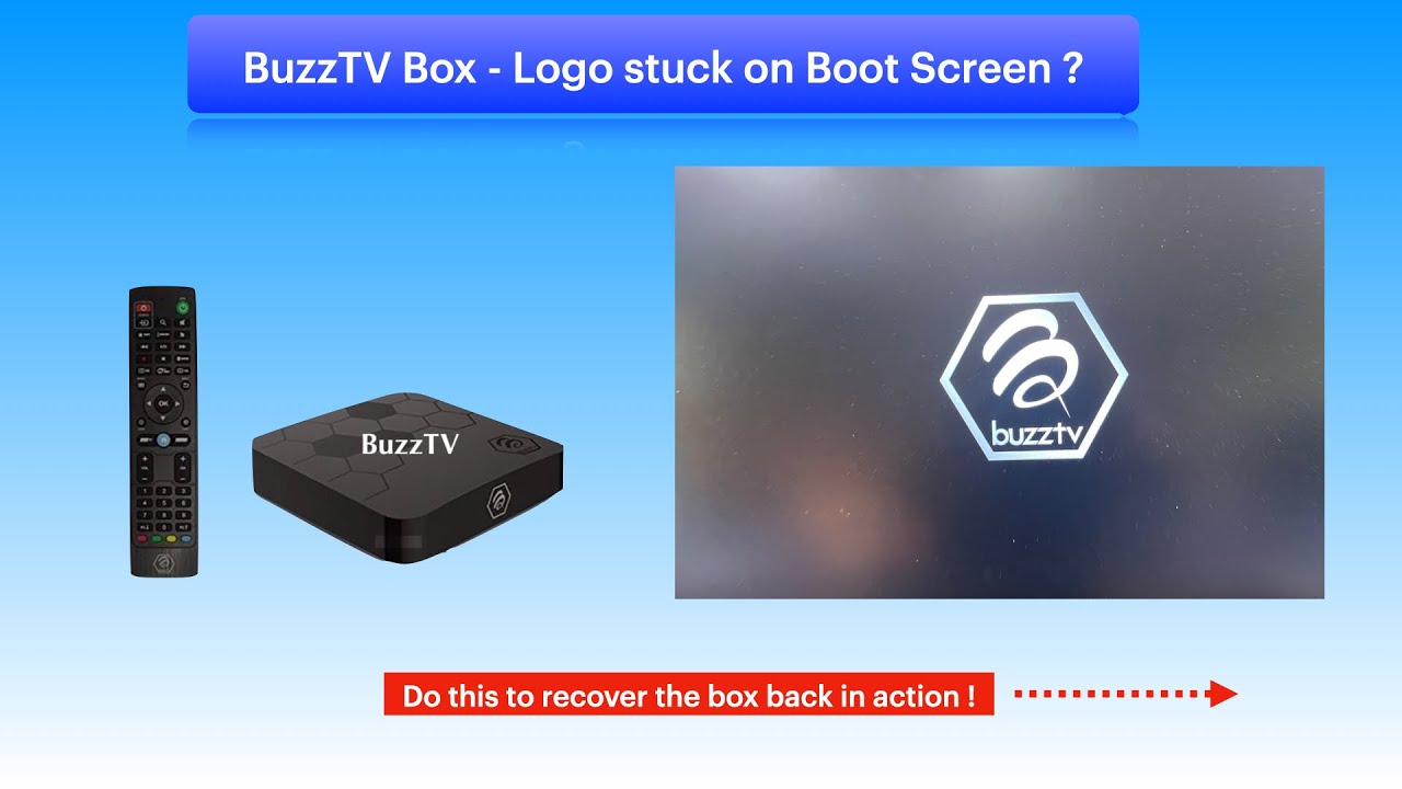

hello again I have another problem I turn on my p6 and the screen is black with the Buzztv logo on and is stuck on loading and nothing works.
Access the master reset.
FYI this will do a complete wipe of all Data and start a full recovery of the Box from scratch
